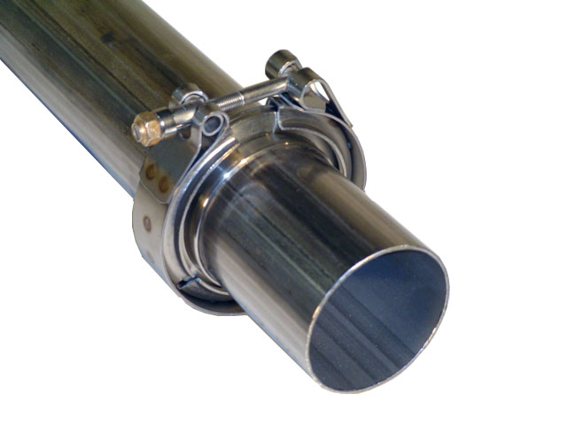

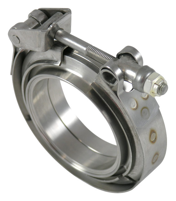

Too bad Pypes doesn't provide a high quality clamp like the attached pics.
I may end up getting it welded, a bit more hassle test fitting and all, but it'll be worth it in the long run.
