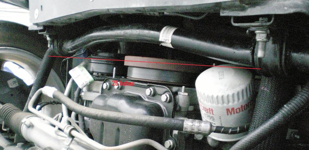

Once all of the products arrived, I began my install. I installed the springs, struts, and strut mounts with no problems. Later, I installed the Bullitt CAI and tunes. When I prepared to install the sway bars, I ran into a problem. The front and rear bars that came bore no resemblance to the pictures on the Granatelli website. The front bar had a ˝” welded on collar on each side whereas the Granatelli bar was completely smooth. The rear bar was shaped differently than the Granatelli bar and the ends looked to be mounted the same as a stock bar, or one of the other available aftermarket bars. The Granatelli bars mount differently and have two different holes for adjustability. However, the hardware I received did look to be the Granatelli hardware for their sway bars. Before beginning my install, I did some research and determined that the sway bars were FRPP bars, but the hardware was Granatelli. The sway bars mic’ed out to 35mm for the front and 24mm for the rear. The Granatelli bars are advertised as 1 3/8” for the front and 1” for the rear. Below you can see pictures of the different bars.

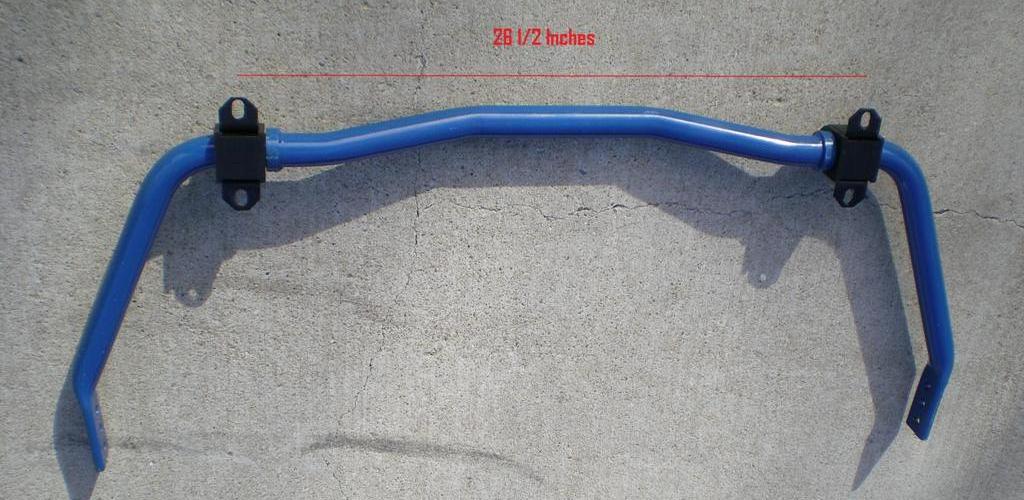

After figuring out I had mismatched parts, I decided that maybe it was no big deal. I had planned on purchasing FRPP bars anyway and the only reason I went with the Granatelli was Tillman was having a sale on them. I figured all of the various vendors’ bars would be similar in quality and all would certainly surpass the performance of the stock setup. So, I began installing the front bars. I removed the stock bar and attached the end links to the new front bar. However, when I went to bolt down the two center poly bushings and brackets, the brackets would not line up with the bolts. The brackets were too wide on the bar and could not slide closer together due to the welded on collars. I had to remove everything and put the stock bar back on. I did not bother to try the rear bar since I was forced to clean up the new bar, bushings, and brackets as I had lubricated everything in preparation for installation and I didn’t want to have to clean up even more if the rear bars did not fit either.
I measured the distance between the inside mounting bolts and found them to be 26 inches apart. I then put the provided Granatelli brackets and bushings on the front sway bar and measured the distance from bracket hole to bracket hole center and found it to be 26 ˝ inches. Although the bracket holes are slightly larger, it is not enough to compensate for the ˝ inch.

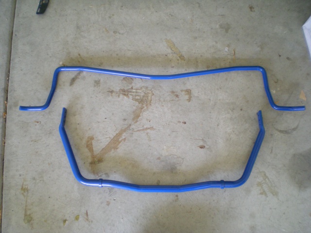

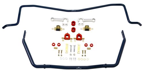

The first set of bars are the Granatelli's, the second from FRPP, and the last, what I received. Pretty obvious I didn't get Granatelli bars. The two other pictures illustrate the stock measurement of 26" between studs and the 26 1/2" between the brackets on the bar I received.

Interesting though that I got a set of FRPP sway bars with Granatelli hardware. I don't even see FRPP products offered on the Granatelli website so that was an odd twist to the event. I'm wondering if Granatelli's supplier screwed up. It seems Granatelli and Spohn buy their sway bars from the same source as they are identical, at least in appearance and design.
