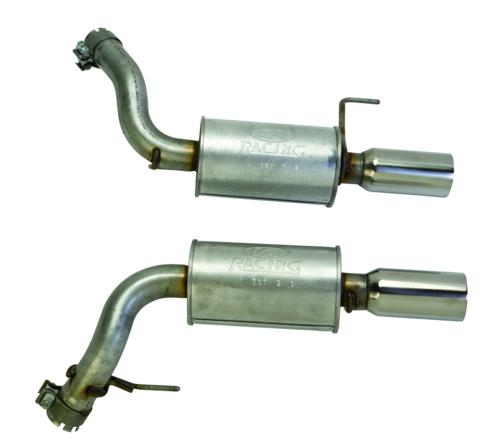

Mustang FR500S Mufflers, Info?
http://www.fordracingparts.com/parts...KeyField=10563
Ford racing now has these mufflers listed on their site as the FR500S mufflers.
P/N: M-5230-S
Does anyone have any info on these or know what they may sound like?

Wow, neat design. They're going to drone badly and will be loud overall.

You drone guys- lol. What they're referring to is the resonating sound that occurs at certain engine speeds. This occurs with EVERY type of exhaust, just more or less with different systems. Those FR500 mufflers are a glasspack, straight through style with resonating tips. They will be nice and deep, loud with a moderate amount of resonating sound.

The aftermarket mufflers all drone, some worse than others. Looking at the FR500S mufflers, I expect massive drone over stock due to the shorter resonant length. My stock mufflers drone, but it's low enough that it won't cause permanent hearing loss.

3-4 years later, I bought the FR500S/GT500KR mufflers and installed them on my 07 GT. I took a test drive today and noticed right away that there was more power available. The engine felt much more responsive at lower RPMs, and it seemed like there was more low end torque. I was getting the rear end to slide around in 1st and 2nd gear without using much throttle at all in slow turns. It surprised me because it never used to do this.
The FR500S mufflers are basically a non-perforated straight tube that breaks inside the muffler body to flow sound into resonant chambers. The tips are 08-09 Bullitt glasspack tips.
The only drone is at high load / low RPM, like pushing the engine a bit in 5th gear at 1000-1200 RPM. I get into this range if I do the 1-3-5 skip shift to save gas in the commute, but if you shift "normally" there is no drone. I am very drone sensitive and at 50-60 MPH, I didn't hear anything obnoxious. There is a significant difference from the stock exhaust.
My complaints are that the weld splatter is everywhere on the joints and even inside the resonator. I can hear some weld splatter rolling around inside the muffler body. The mufflers don't come centered properly, so there is some adjustment to be made using the intermediate/mid-pipes unless you want to heat and bend the brackets. The tips actually look very good but I still prefer the slash cut tips from the stock mufflers, as they match the GT and GT500 bumpers a lot better - but the straight cut Bullitt tips look very good.
I had Pypes Violators 5 years ago, and the exhaust note is *similar* to the FR500S, but the Violators were much deeper and had obnoxious drone. The FR500S has a higher pitch exhaust note (which I like).
