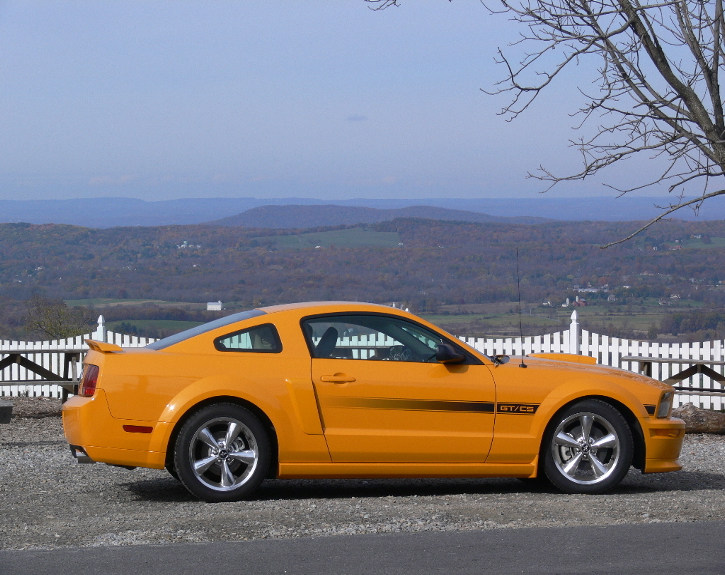

I have mine all FORD, the handling and the power pac. The judges at the mustang shows don't take points off for FORD parts. If the dealer does the install it's still under warranty.
