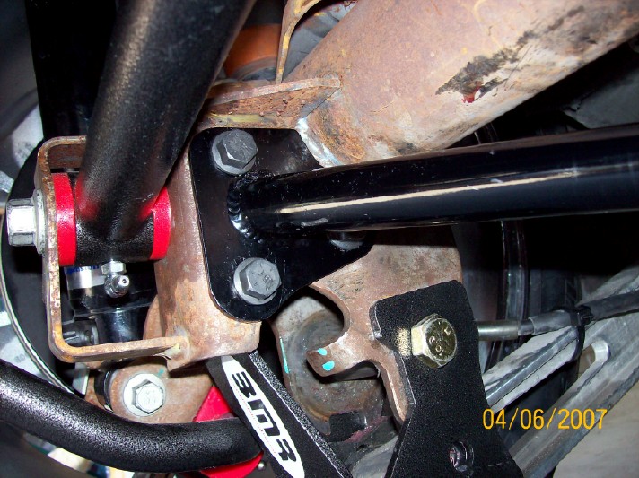

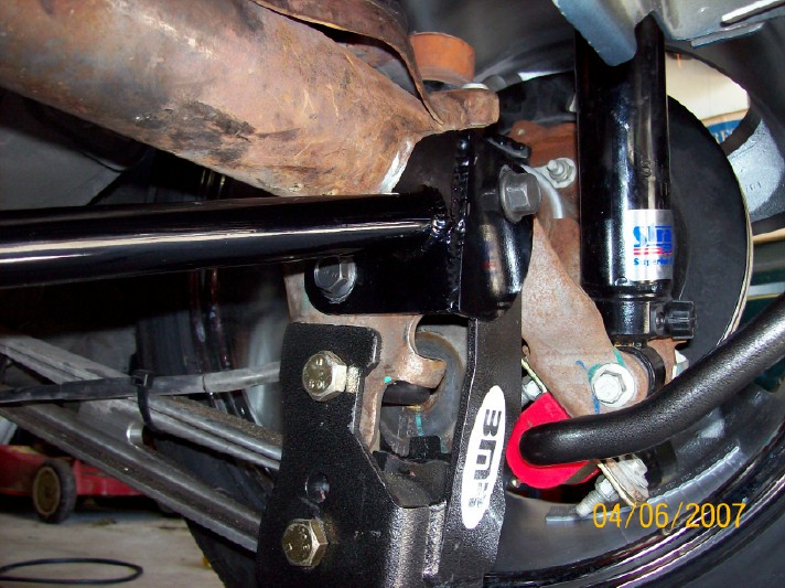

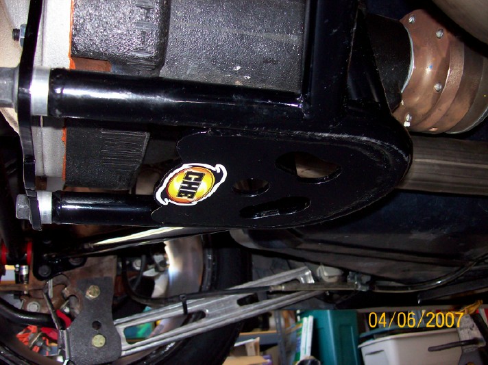

I routed mine on the inside of the LCA - not through or below the LCA.
Attached Thumbnails Lower Control Arms Question?-100_0387.jpg   Lower Control Arms Question?-100_0388.jpg   Lower Control Arms Question?-100_0391.jpg

tmcolegr-
I see you also did the relocation brackets. Is that because your car is lowered? I didn't order those so I hope I don't need them. I guess it's the zip tie for me too.
Old Apr 8, 2007 | 10:54 AM
tmcolegr's Avatar
Joined: November 29, 2004
Posts: 634
Yes I'm using the BMR lowering springs along with a ton of other suspension mods.
