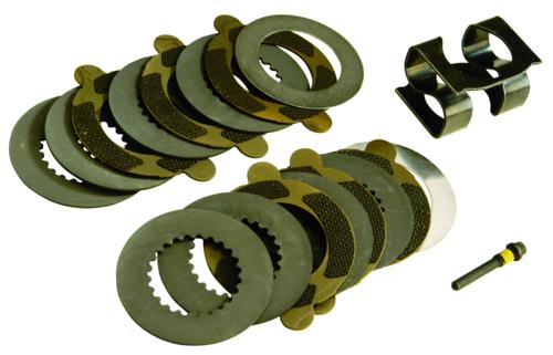

As far as I can tell, there are really only two Ford/OEM clutch designs used in the T-lok:
Type "B" which are the ones that we've used since the mid 80s in the 8.8". They look like sandpaper discs.
Type "C" which is the carbon-fiber clutch used in the 03-04 Cobra and the 07 GT500. Rumor has it that Ford used these in the S197 GT as well. They have a shuriken-like friction material pattern.
I posted the FRPP pics in various TMS threads before.

Thanks for taking the time to take the photograph!!!!!!! Strangely, the white box in the upper left hand corner looks like the T-lok rebuild kit. The FRPP M-4700-B kit uses the same box.
On the left is the carbon-fiber clutch used in the 03-04 Cobra, 07 GT500, etc... On the right is the regular "B" clutch used in 86-up 8.8" Traction-Lok units.
FRPP pics:
Type "C" carbon-fiber clutches:
Type "B" regular clutches:
Was the clutch on the left taken from your factory 05-up Mustang GT rear end?
According to Ford Racing:
  • M-4700-C
  • Kit includes carbon fiber clutch pack, shims, S-spring and instruction sheet
  • Fits all 8.8" Traction-Lok differentials
  • Carbon fiber discs designed for higher torque usage
  • Used in 2003-04 and 2007 SVT Mustang Cobra

Yes it came out of my 05 so it appears that the 05 had the carbon fiber clutches.
You are also correct in that the box was the M-4700-B which is what I have in the car now.
That may be why the originals lasted a good 650 runs.
