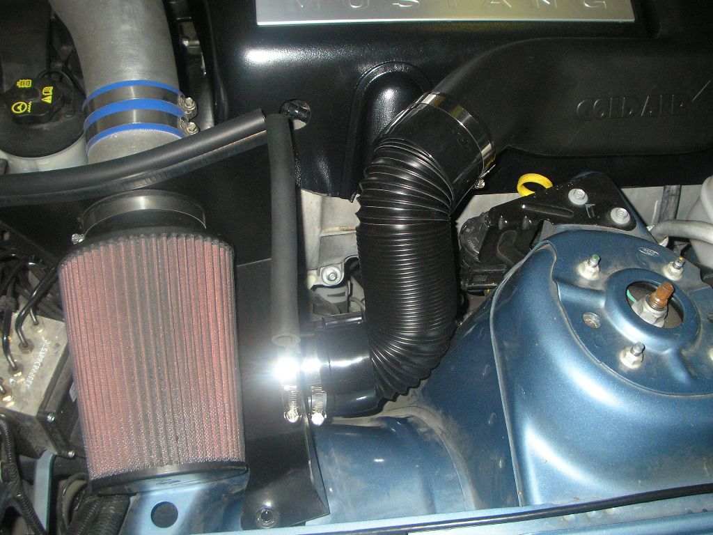

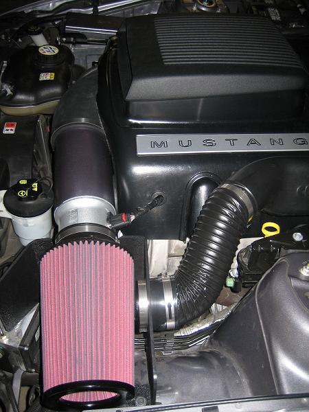

Scott that install is outstanding. I am wondering if you race this car as I am thinking that cover holds a lot of heat in the engine and these motors do not like heat. Please advise.
Old Jan 21, 2007 | 06:12 AM
tom281's Avatar
Joined: October 8, 2005
Posts: 12,395
Likes: 29
From: Medina county, OH
FWIW- my car has been down the 1/4 about 12 times one day late last summer and I had no problems. I was worried about it when I installed the kit but I've never had any problems.
Old Jan 21, 2007 | 06:16 AM
70MACH1OWNER's Avatar
Joined: January 9, 2005
Posts: 6,982
Hey Bill,
I also was kind of worried about the cover keeping additional heat trapped under it but I have seen no evidence of it. I probably will never race this car as it is more of a daily driver. I installed the shaker last Feb. and have put approx. 10k in miles even thru the hot summer months and I can say... no issues. It may acutally be a trade off as when I am sitting at a traffic light I can see heat coming out around the shaker that would otherwise be trapped. And when the car is moving if sure it makes no difference. There are alot of cars coming out of the factory with complete engine covers on them now. BMW...Lexus... etc. As you can see from my pictures mine needs a good cleaning but I love the way it looks and get tons on compliments on it.

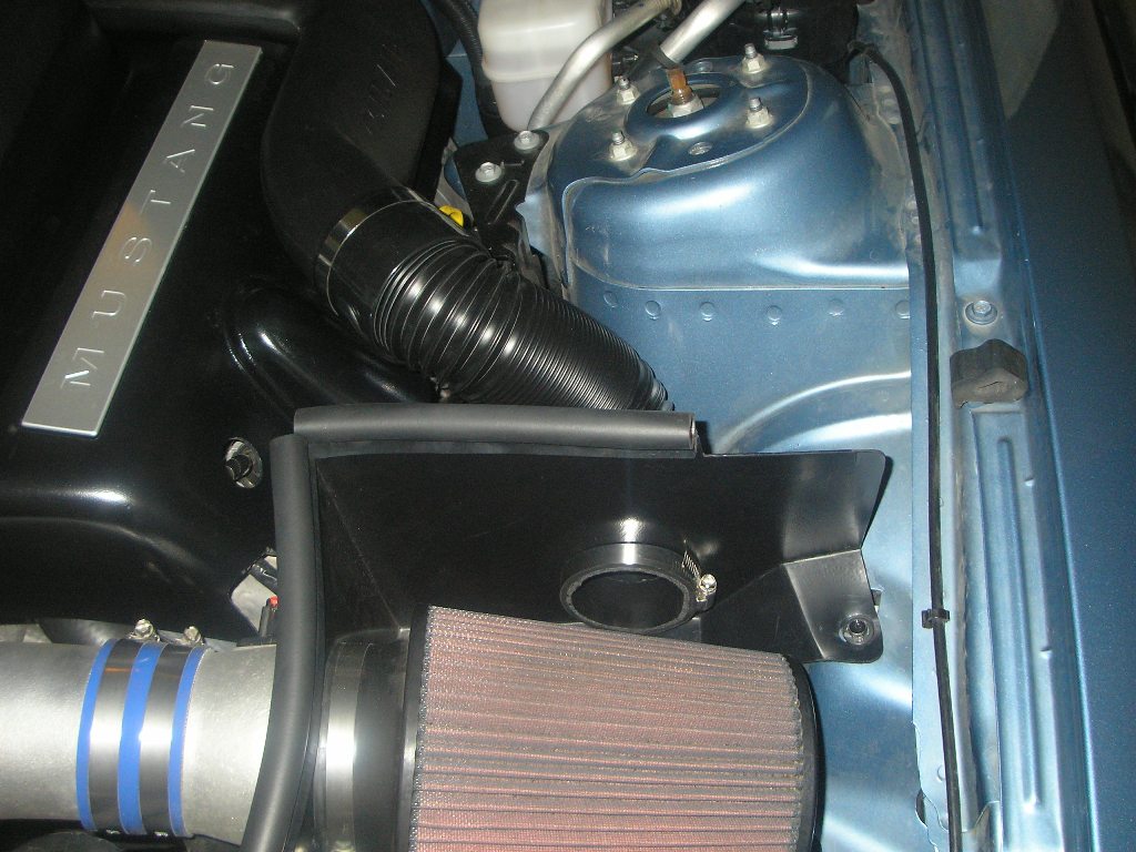

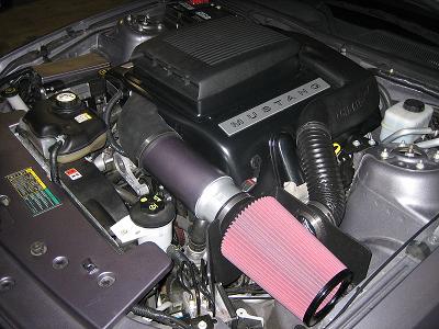

Finished Work.
Thanks to all of you that guided me in the right direction. I also picked up some grommets where the pvc tube and maf connector comes through the shaker shield. Oh, and there was some dremmel cutting going on with the area around the throttle body, the shaker shield was digging into the JLT inlet tube.
The inlet cutout on the JLT heatshield looks as if the tubing is hitting the filter, but thats just the camera angle, theres room for movement without hitting.I re used the coupler that joined the tubing on the shaker to the factory airbox and slid this into the newly created hole in the JLT Heatshield. Clamped both sides down.

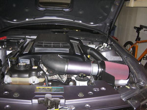

Now I'm looking for some rubber trim to go along the top of the heatshield, as seen on the C&L's. Example of pic below. Anyone know where I might find this? I've looked at Napa, Kragen, Lowes, Home Depot....
