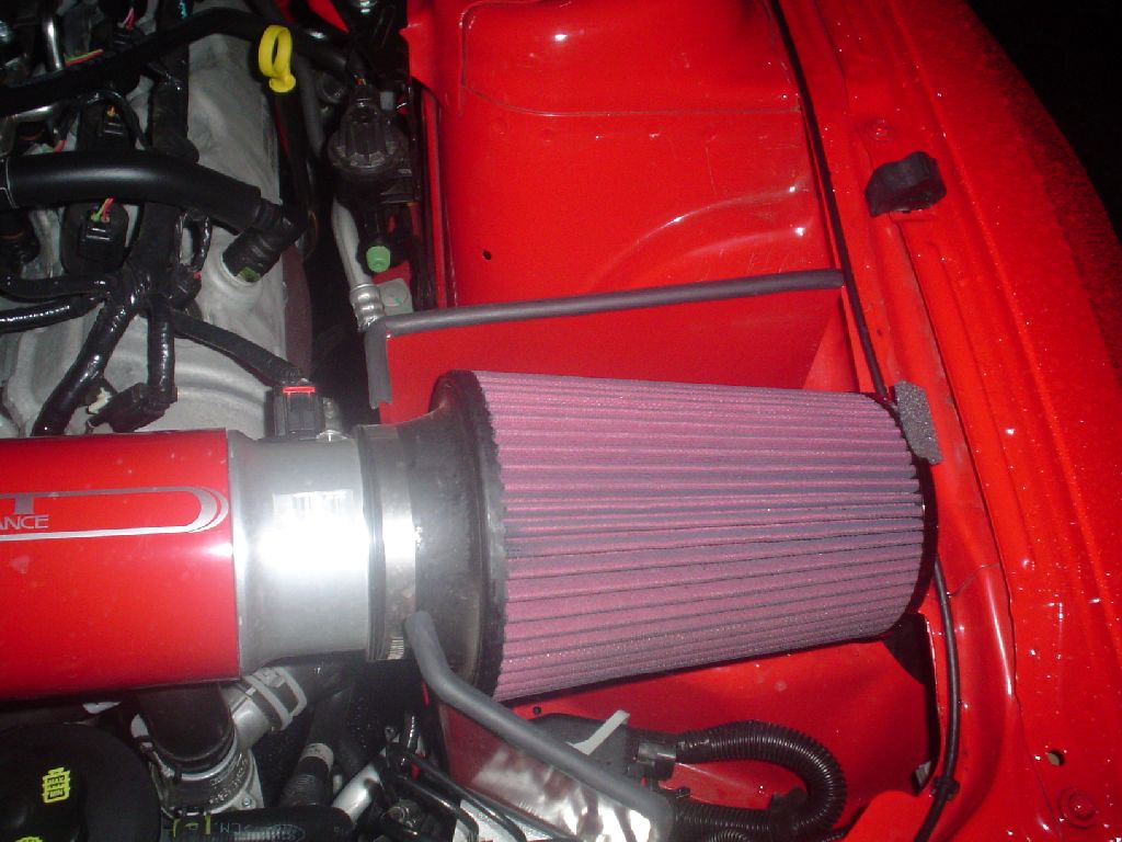

Here's what I added to the edges of my heat shield,top & bottom where it rides against body, lines, etc.
I used windshield washer tubing & slit it along 1 side, just pressed it on. The heat shield was wearing into my hood liner.
You can also see where I put a small piece of foam weatherstrip on the end of the filter, as it was rubbing on inside of hood.

I had to tweak mine as well as the filter was rubbing on the hood. I used pre-cut self adhesive felt piece, however, I placed it on the hood, not the CAI. I think the weatherstripping would look better on the hood(not as noticable) than on the filter- IMO

Good call guys! Looks good. My filter has also rubbed into my hood and the paint off.
