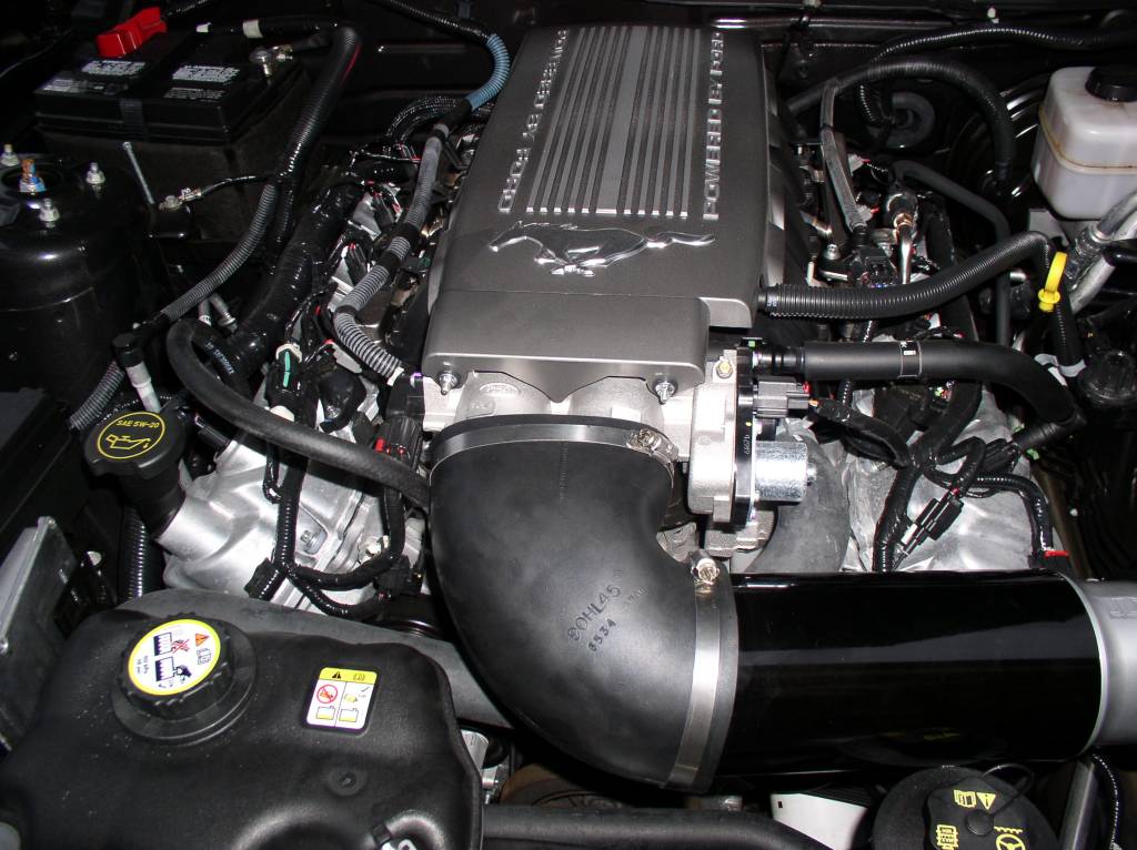

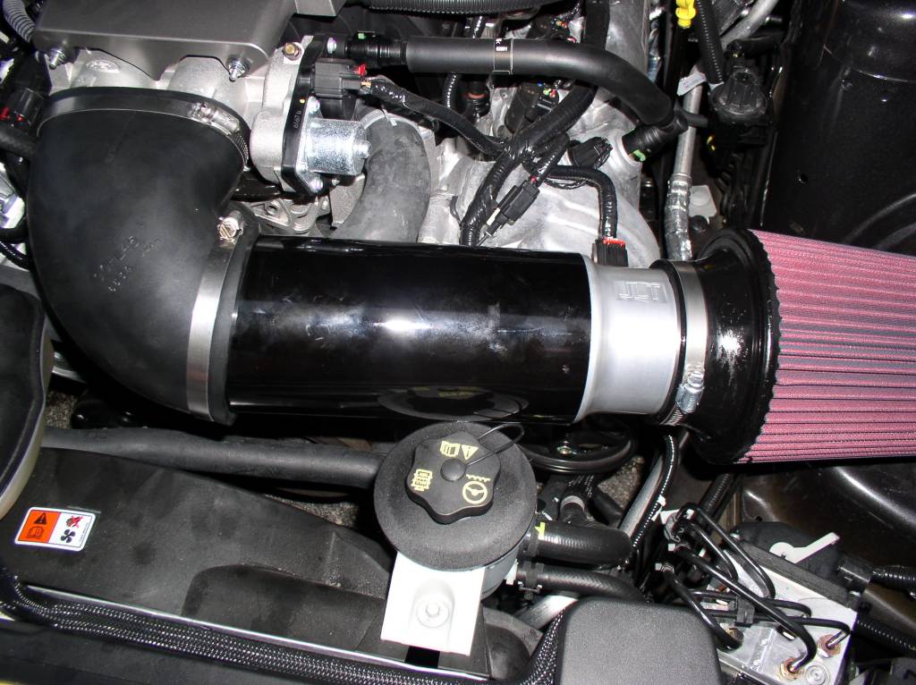

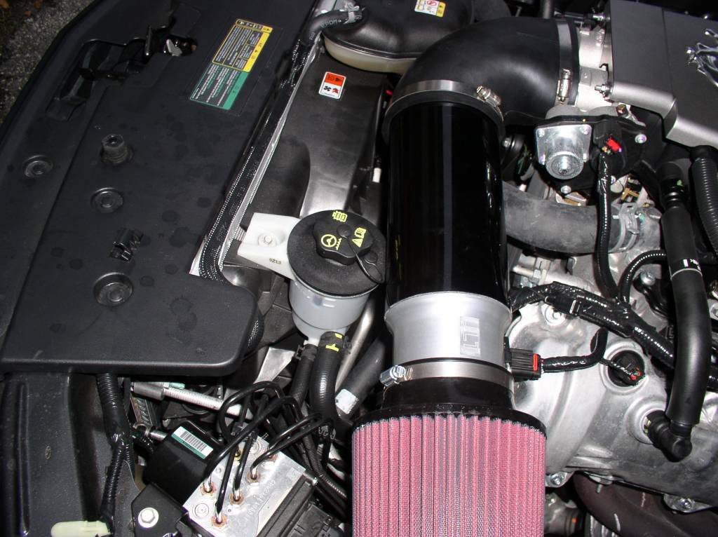

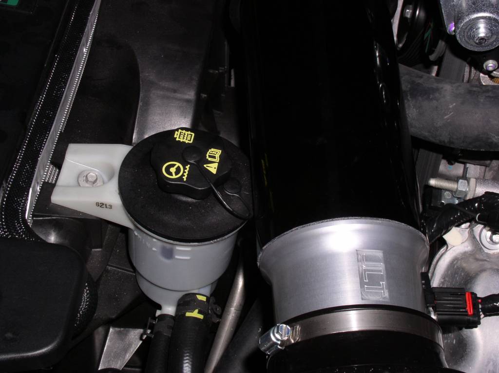

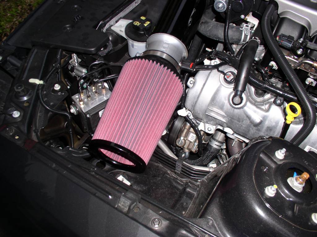

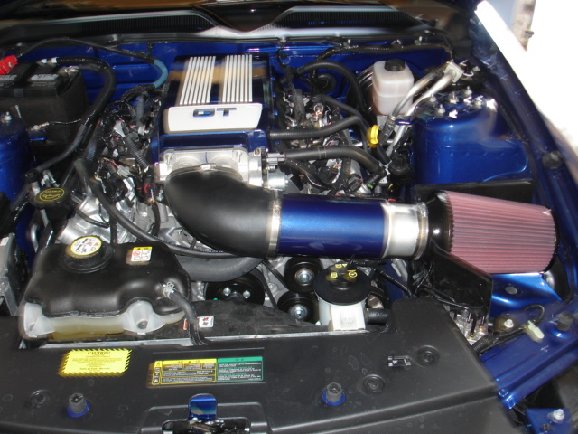

wow, i got it tuned and boy what a difference. I can't beleave how well it responds now. and that's with an 87 tune. will retune to 91 when my tank get lower. Now for the problems i have now. i wasn't able to install the heat shield. I have stretched the body and filter as far as i could and the wide part of the filter blocks it from settling in the cradle so i'm running without the shield. here are the pics of my install. i would appreciate any help, maybe from people who had the same problems.

my install pics
here are the pics of my stall
Attachment 13913
Attachment 13914
Attachment 13915
Attachment 13916
Attachment 13917
Attached Thumbnails JLT Help!!!!-cai-001.jpg   JLT Help!!!!-cai-002.jpg   JLT Help!!!!-cai-003.jpg   JLT Help!!!!-cai-006.jpg   JLT Help!!!!-cai-005.jpg

I am pretty sure you have the elbow on backwards. Try switching it around. The reason I am so sure is I did the same thing when installing mineand could not make the heat shield fit properly. When I installed it correctly the heat shield goes on perfectly.

thanks scott, i was sitting here and started thinking to same thing. well i'm glad i'm not the only one *L*

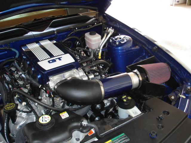

Attachment 13918
Attachment 13919
Here are some pictures of mine if it helps. If you look at your first picture, compared to my first picture you can see the difference in positioning of the elbow. Yours comes out further and then to the right pushing your tube too far towards the front of the car and that is what is giving the problem fitting the heat shield.
