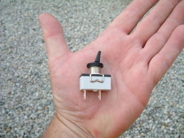

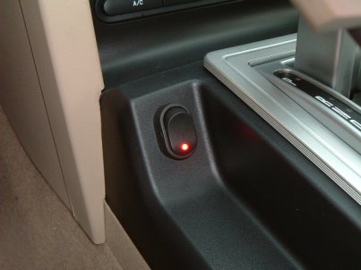

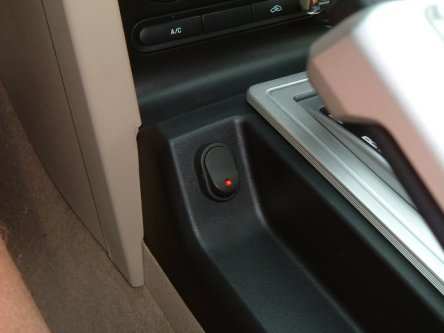

Okay....my install is complete. Here is a couple of pictures of the switch with the LED I chose over the one that came with the SLP kit. I think you will agree it looks better with the Stangs interior and the LED at least tells me the **** thing is on. I did a test drive tonight and I want to share some info I have not seen posted before. The biggest question I had about this mod was what the hell happens if you are driving down the road and hit the switch. If your foot is not on the brake pedal......nothing. What I now know is the SLP solinoid is a one way check valve. If you activate it when driving and put your foot on the brake pedal it will apply the front brakes according to the pressure applied and it will continue to hold that pressure. It is very easy to control. But it will hold that pressure until you turn the switch off. No disaster!!!
Here is a few pics of the cheapo toggle switch you get with the kit and a pic of my new switch with the LED turned on and off. I think you will agree it looks like it goes with the cars interior. I want to thank TOM281 for the suggestion on where to place the switch. Very handy and I don't think the wife can see it from the passenger seat!!!! The camera's flash makes the LED in the off position look lit but it is completely dark when off. Ohh yeah the **** thing works really good. I will post a vid in a couple of days when I can recruit a cameraman!!!

I love it, great switch location. Convenient, but stealthy with the ebrake down isn't it? Congrats, hopefully I'll see it first hand in a few weeks.
Old Sep 23, 2009 | 05:25 PM
  #40
70MACH1OWNER's Avatar
Joined: January 9, 2005
Posts: 6,982
You are correct... With the E-brake handle down it is even more stealty. I can lay my hand on it with ease. And my test drive tonight produced a lot of black flakey stuff in my rear wheel wells. :bur nout:
