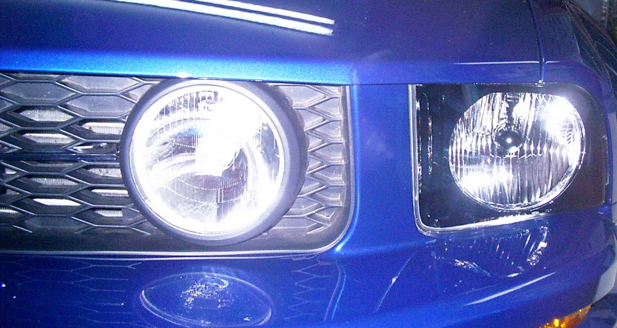

I took some pictures outdoors during the day.
They are definitely brighter than the highs.
I am not sure if they are brighter than the silverstar ultra, but the reflectors aren't hazing.
Highs & Driving lights
Attachment 22294
Attachment 22295
Attached Thumbnails I Got Sick of Foglight HAZE !!!-highs-drivin.jpg   I Got Sick of Foglight HAZE !!!-driving-lights.jpg
