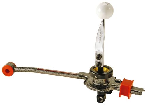

Below is an illustration that shows how the assembly should go together inside the car... Looks like they used the stock style handle on yours (reuses the stock ****)... Also I found some illustrations/pics from FRPP that basically shows that the FRPP and HURST are the same... It looks to me like your installer, installed the pooer backwards (w/linkage offset to passenger's side)... The only way to be sure is to get under the car and have a look-see..... What is for sure, is the fact that your shift handle is on the wrong side...

<div align="center">05 MUST SHIFTER W ****
M-7210-T1
</div>

The reason I suspect that your shifter is installed backwards is that if you take a close look at the picture of the 05 MUST SHIFTER W **** M-7210-T1 (above) and closely inspect the bottom of the chrome stick you'll see that it is a serrated surface on one side (mating surface) covering the bottom 1/3... This serration (if I recall correctly) is also present on the nub of the shifter assembly... Well, these two serrated mating surfaces are ment to face each other... Therefore, logically if your handle/stick is bolted together in this fashion, then the only other reason for your bolt heads on the driver's side is the fact that the linkage offset is backwards....
I hope this makes sense....
