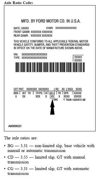

Open the driver door and look at the dataplate. Find the axle code and that will tell you.
AXLE code:
BG = 3.31 non-limited slip, base vehicle with manual or auto
CD = 3.55 limited slip, GT with manual
CG = 3.55 limited slip, GT with auto
AXLE code:
Neil is right on...

yeah but he has a 2007, in 2007 the GT with manual had 3.31 stock and 3.55 optional and my GT came with 3.31 gears and it is an auto and mine is a 2006

AXLE code:
Sorry to differ, but my sticker says CG, and I have a manual with a 3.55 limited slip.
