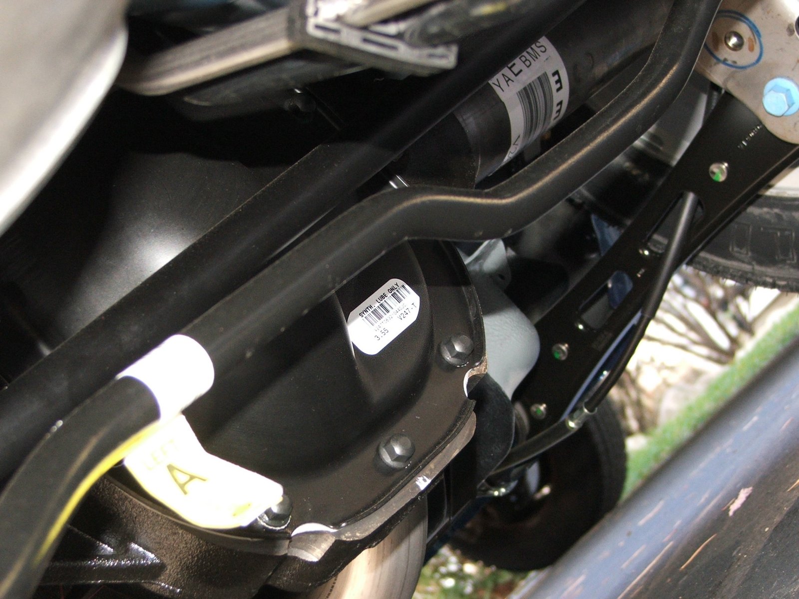

They reduced the ratio for better gas mileage. I did a cost benefit analysis and the 100 RPM difference in 5th gear wasn't going to make a big difference. I do not plan to change the ratio, so I paid the $87 for the factory 3.55s
Here's a pic of the axle tag on a 07 GT.
Attached Thumbnails How to decode for a 3:55 Rear Axle?-s197_axle.jpg
