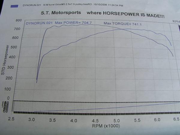

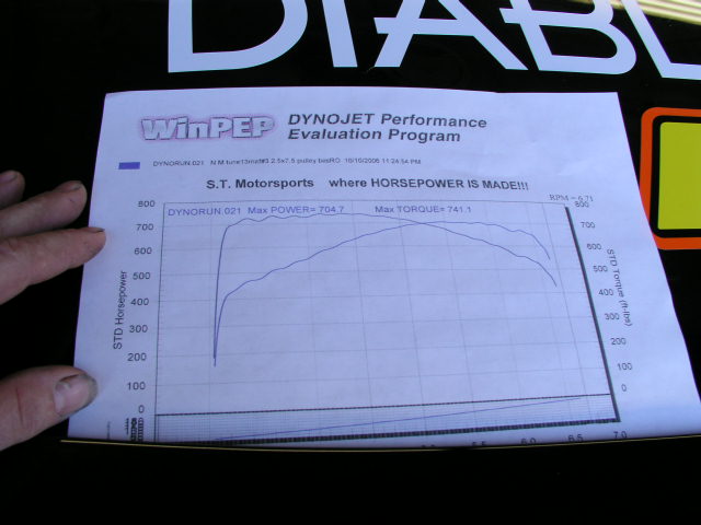

Adam at ST Motorsports has been working with Jim and Ken over at KB ,running alot of tests over the past few weeks and this kit will not disappoint!Jim has built one HELLUVA BLOWER!!!! Heres the stats on the car
704 hp 741tq Tuned with Diablo CMR w/MaFia
Basically its a stock GT with a forged short block...mods as follows
NEW KB 2.6 H/O kit
cobra forged short block with stock compression
Accufab t-body (60mm) ...new one being built for future testing
custom 112mm mass air meter
60lb injectors
255 walbro blower specific
clutch master stage 4 clutch
THATS IT.
The heads are stock 3 v heads,stock cams,stock exhaust manifolds,full exhaust to rear bumper,etc...
Saleen and whipple are'nt in this ballpark with equal mods. The one downside to the new H/O system is you have to run a minimum 15 psi and can go no bigger than a 3" pulley. Anything under 15 psi and the car runs like crap so it is not for a stock shortblock. However, adam is selling complete rebuild blower packages for 14-15K installed and tuned so for less than 50K total (including the car) you can have a 700+ HP street killer.
In case you're wondering, the dyno was done @22 psi with 24ยบ of timing with sonoco 116. The car starved out at 5800 rpms cause it's only got a single walbro and BAP!! That's it. A simple matter of twin GT Supercar pumps or GT500 pumps and it will go even further easily.

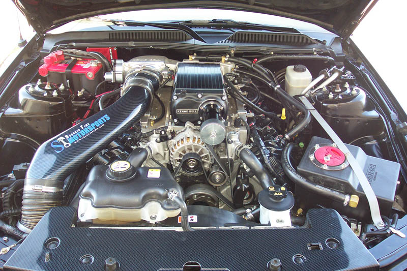

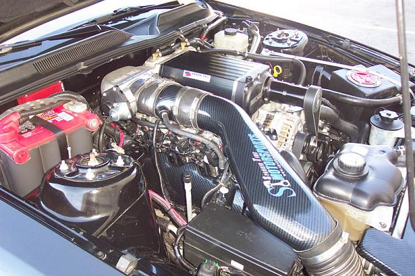

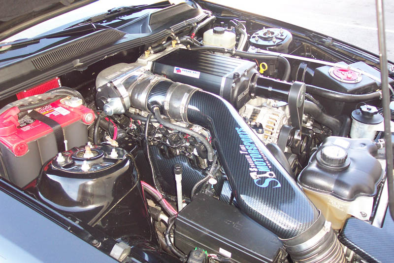

A couple pics of the motor and custom air meter...
