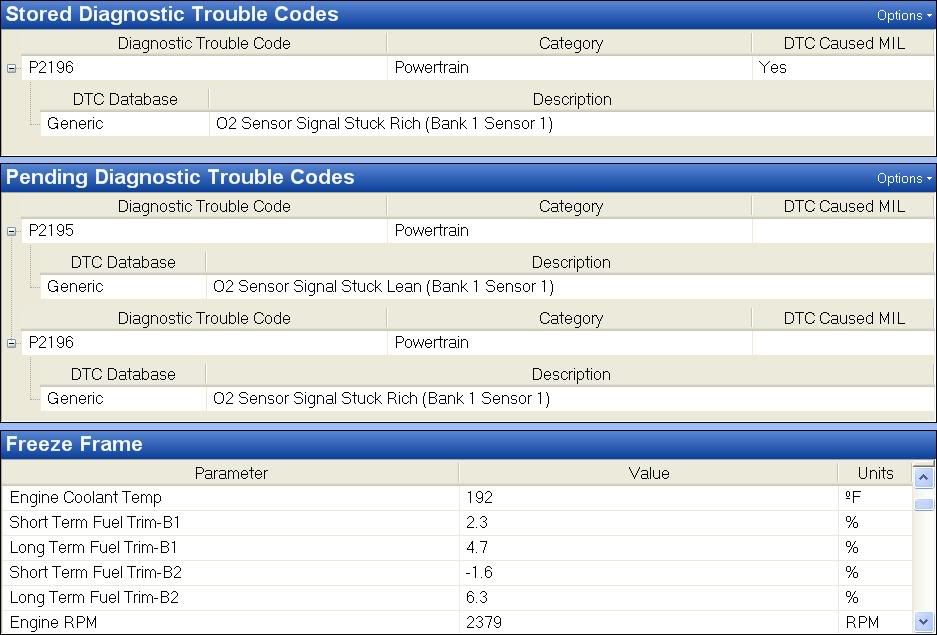

ever since my long tubes went in, i cant get the CEL to stay off. i keep getting the same thing. i am running MIL eliminators on the rear 02 sensors. i brought the car in to a shop, and they changed the rear passanger side 02 sensor. now i am still getting this code! help me out its driving me nuts!! would i have to disconnect the battery after having the new 02 sensor installed?

Bank 1 Sensor 1 is the Passenger side upstream O2 Sensor. Are you running the O2 Sensor in the LT Headers? If you are did you possibly get something on the end of the Sensor when re installing it? Based on the code you need to replace that upstream sensor.
You DO NOT need to disconnect the battery after installing a new sensor but you do need to clear the codes with the scan tool/Tuner

changed the upper sensor, so far problem is solved...hopefully! they had changed out the wrong sensor. thanks for the help!
