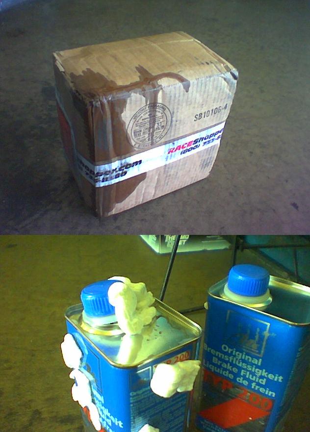

Originally Posted by wjones14
.... DOT4 fluid that came in a blue metal can (I think it may have been from Germany, but not sure). .....
This stuff in the pic below? Its what I used. Too bad UPS threw the box from the truck when getting out to deliver.

is that ate super blue? oh and if someone could share the bst way found to bleed out the brakes on a s197? i was thinking about getting a vacuum pump bleeder, or a motive power bleeder.

No but heres super blue, and where I got my fluid from
http://www.raceshopper.com/ate_brake_fluid.shtml
Yeah, that's the stuff I saw, ATE Super Blue!
