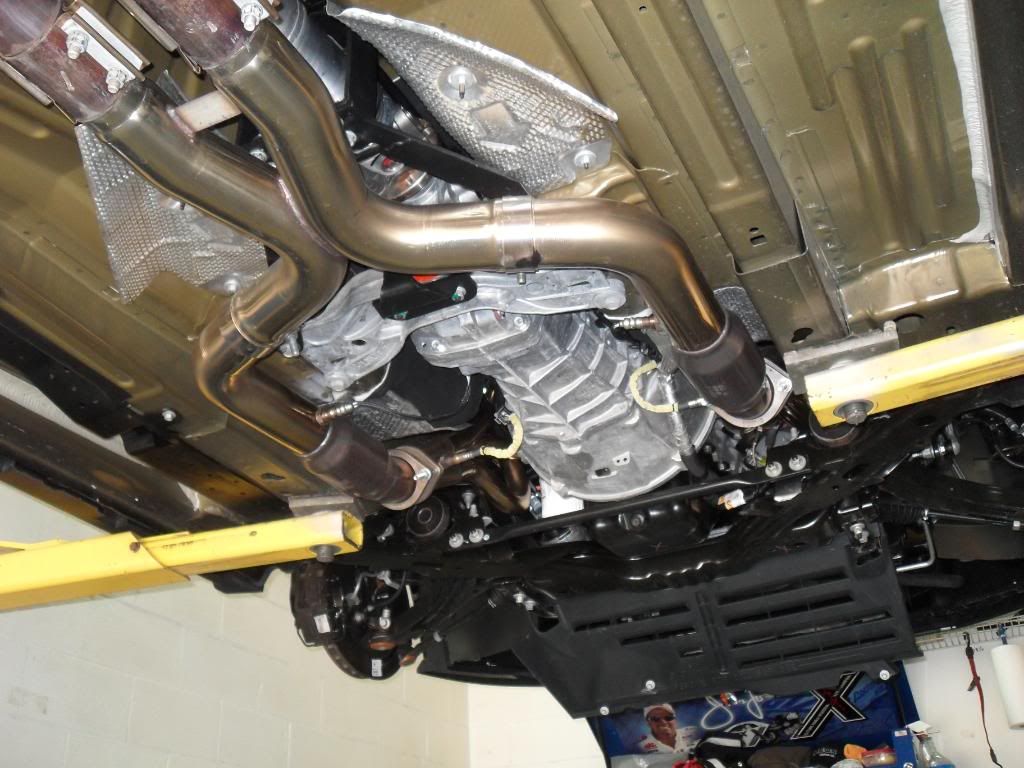

Ahh the X vs H argument! Here's the skinny, yes, X flows better than H, and yes, better flow equals more power. How much more power? On a stock or bolt ons car, not a lot. Definitely single digit differences. On a ~3500lb car that already has upwards of 300hp you're not going to feel a difference in power between the two, even if the dyno proves there is one. Now on a really heavily modified car where you absolutely need every bit of flow possible then yes, X is definitely the way to go, but 99% of us wont ever get to that level of performance.
So how do you choose? Sound. Pure and simple. Listen to a bunch of cars on youtube or whatever and figure out what you like. There is a big difference in sound between the two. I think the easiest way to describe it is that the X pipe makes a raspier, almost more 'exotic' definitely more 'modern' sound whereas the H makes a deeper, more 'old school muscle' tone. Of course your axle backs will have an affect on this as well. It's all down to personal preference, some like the raspiness of the X, some don't.
