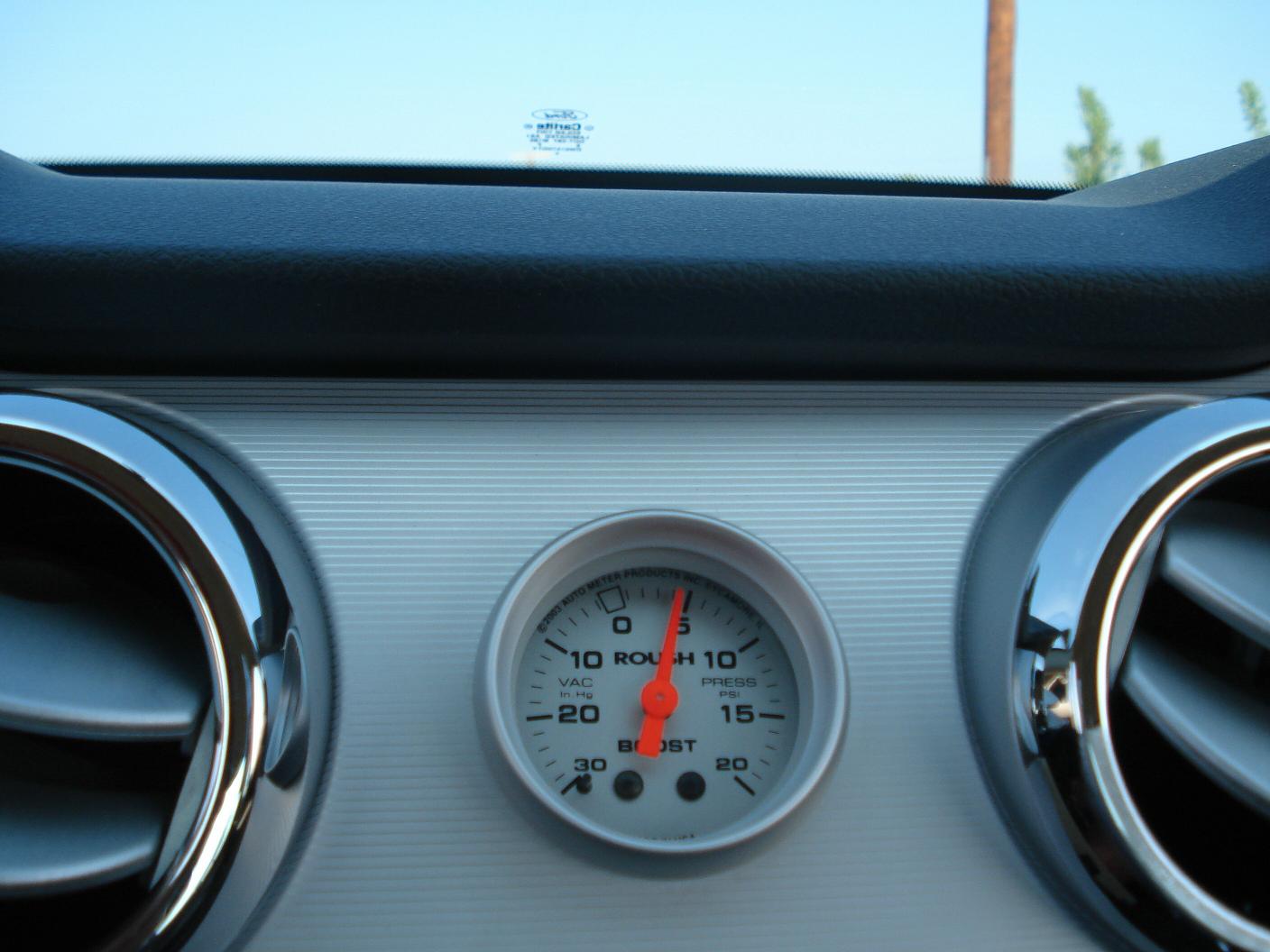

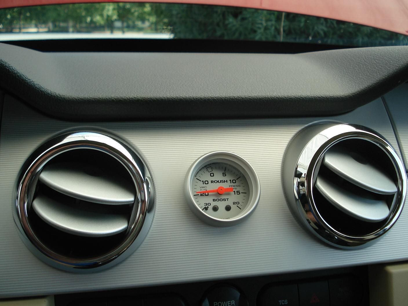

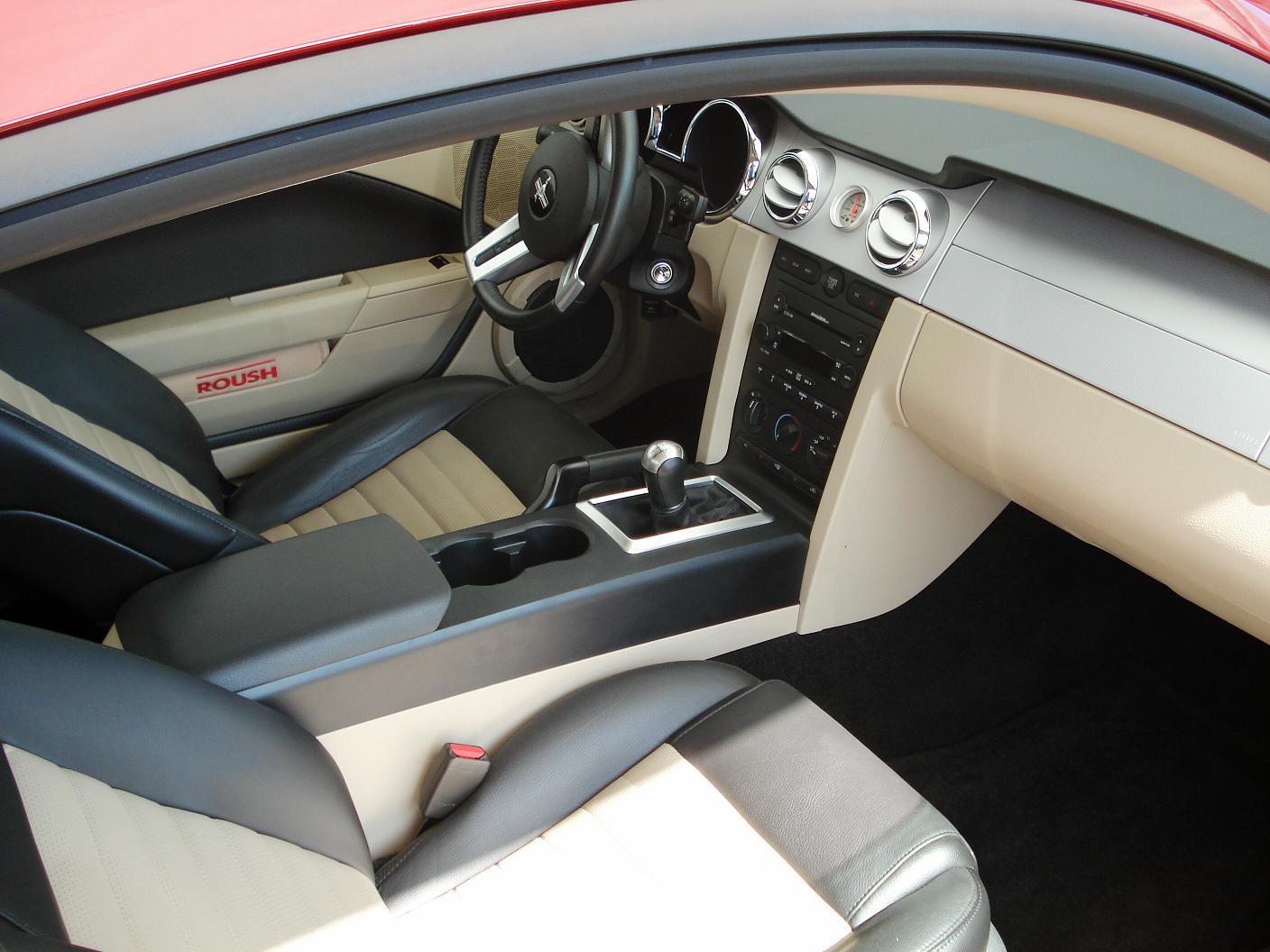

Here is My Setup I had in My CS. Pretty Clean I Think!
KC
Attached Thumbnails Gauges for Supercharger-gtcsblowerboost.jpg   Gauges for Supercharger-gtcsint.jpg   Gauges for Supercharger-gtcsboostvacuum20.jpg
