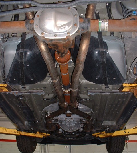

I'm in no ways saying yes or no.. but... the FRPP X is a direct replacement for the stock H...
The only difference spacewise is the clamps that attach it.
(the stock is clamped 2 times (rear of the H)
The replacement is clamped 4 times (front/rear)
I'll go back today and get some pics while its in the air
Old Oct 7, 2006 | 10:57 AM
Boomer's Avatar
Posts: 10,446
Likes: 12
From: Canada
Pics added...and pipes fixed

Here are some pictures of the X-Pipe. I hope it helps but Boomer's comments are probably correct.
I didn't notice that you had posted pictures.
