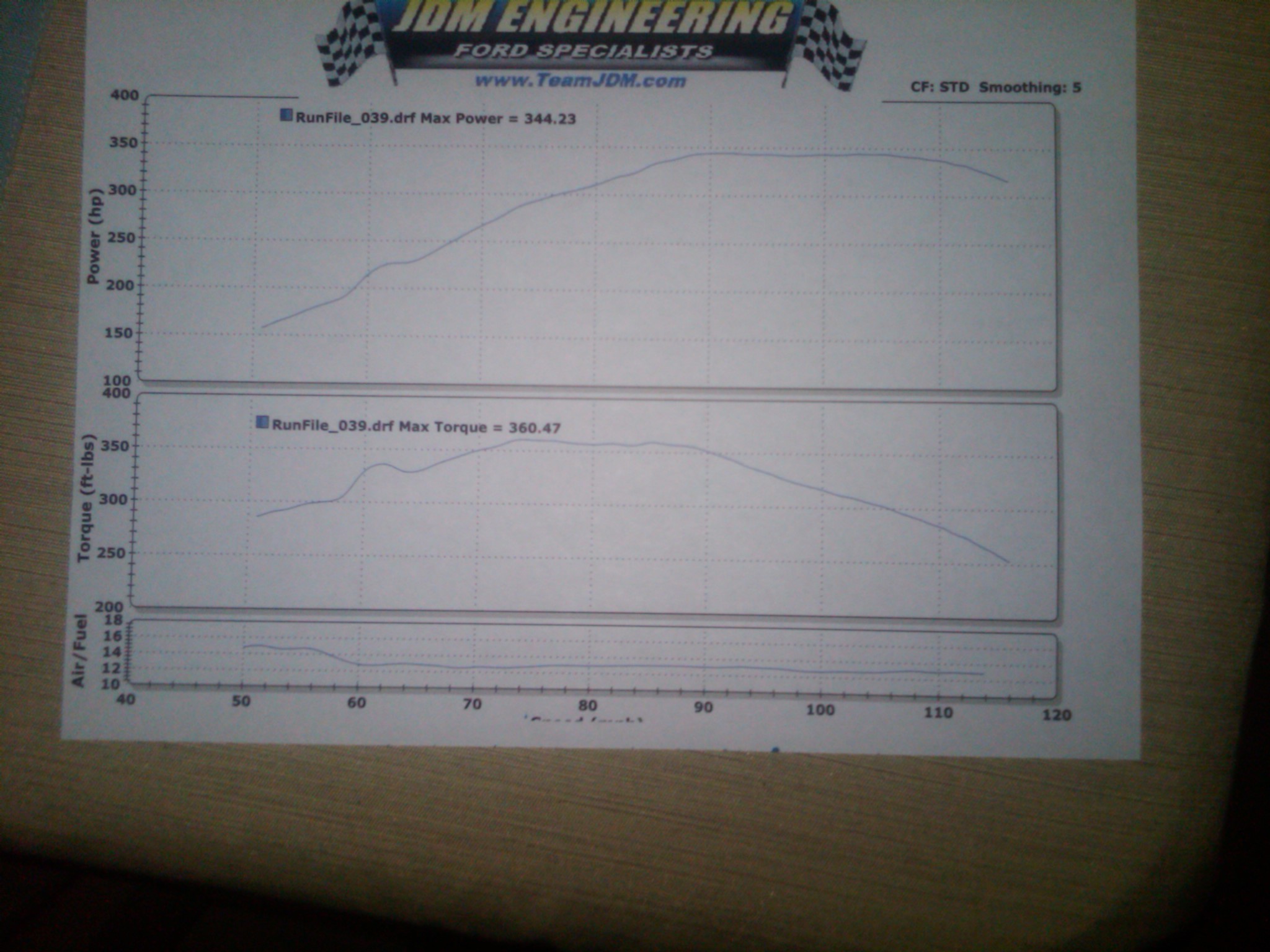

Okay, here's the dyno from my install. FRPP intake (the breathing one), throttlebody, steeda UDP, FRPP hot rod cams, JDM CAI/tune and Kooks LT catted. Got 3.73 installed with that today did the one piece driveshaft and roush extreme cat back. Definitely loud when you get on it. The dyno was done before today's installs. Going to wait for some cool weather and maybe retune and see what the DS/exhaust did for rwhp.

^ That's close to 335rwhp SAE corrected not sure about the torque.

All I know that it was a hot muggy jersey day 90's and 50% humidity when this was done. It was a big jump over the base that an auto gt would put out on the same day. very happy with the combination so far. Will go back in Oct to do a cooler weather pull and tune I think.
