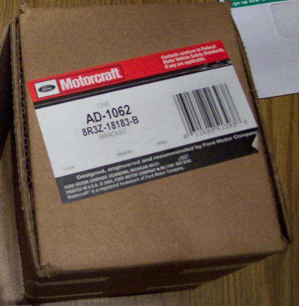

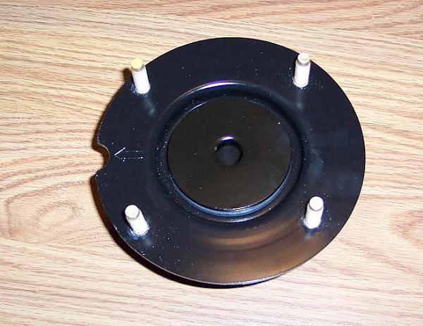

Old Jul 13, 2008 | 10:25 AM
Stoenr's Avatar
Joined: May 31, 2005
Posts: 3,270
Likes: 24
From: E. Tennessee
Sure do
They have gold studs, one identifier on the upgraded ones.
Attached Thumbnails Front Strut Mounts - Steeda or GT500 ? Have strut popping...-mount.jpg   Front Strut Mounts - Steeda or GT500 ? Have strut popping...-mount2.jpg

Originally Posted by Stoenr
Sure do
Thanks!
While I'd love to do the Steeda thing, I need to be financially responsible and these should do job.
