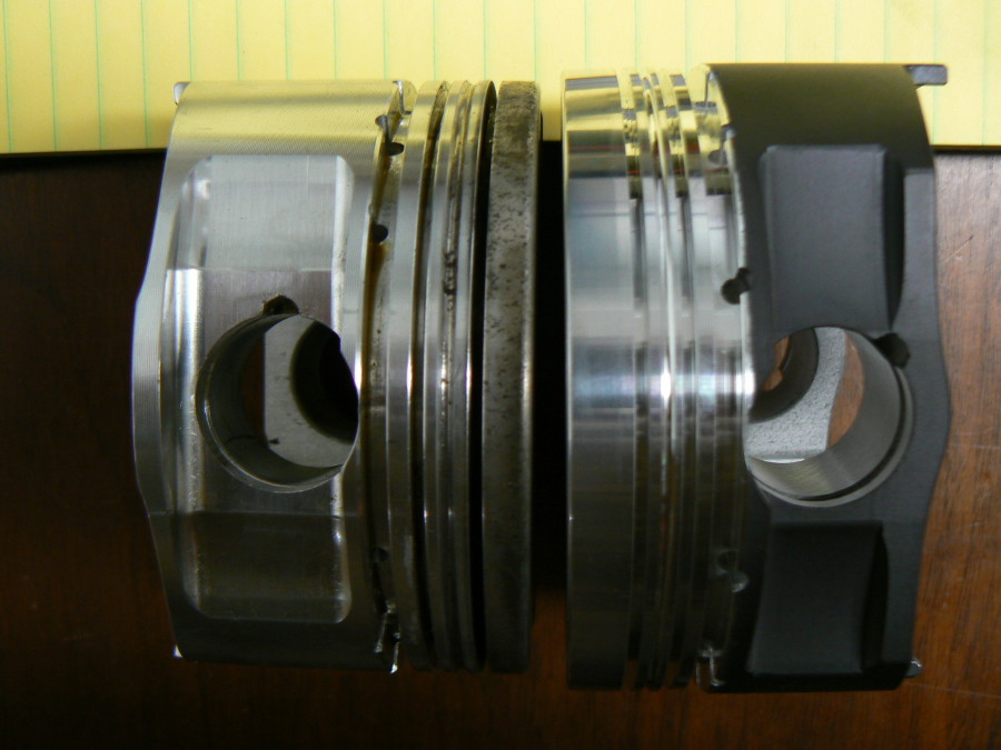

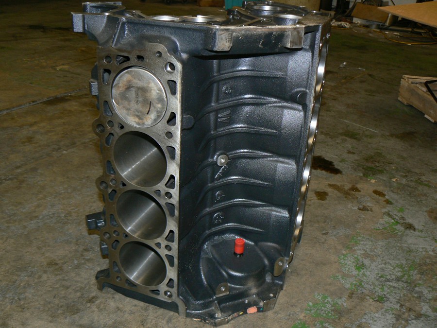

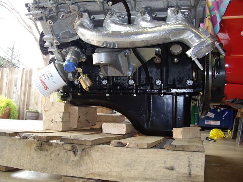

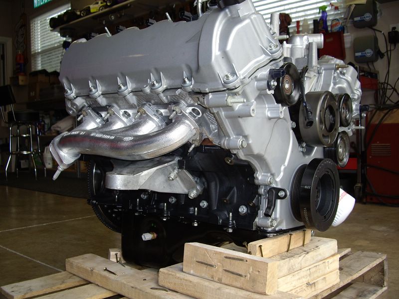

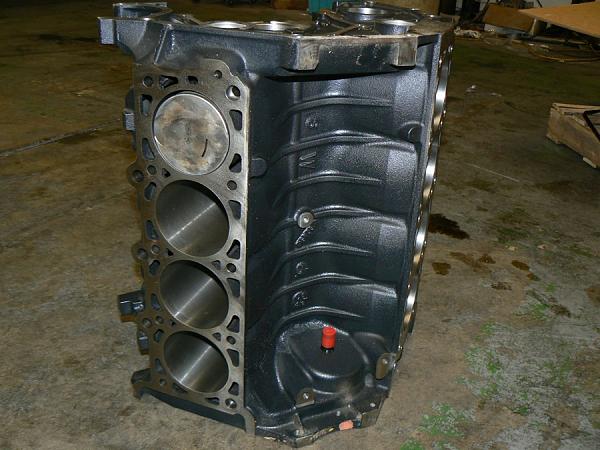

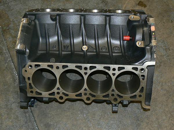

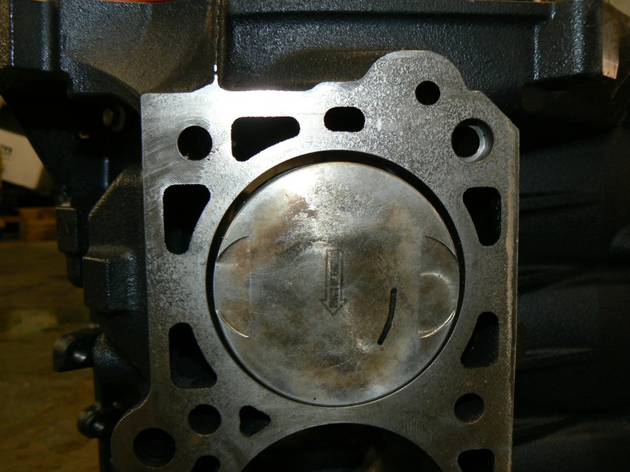

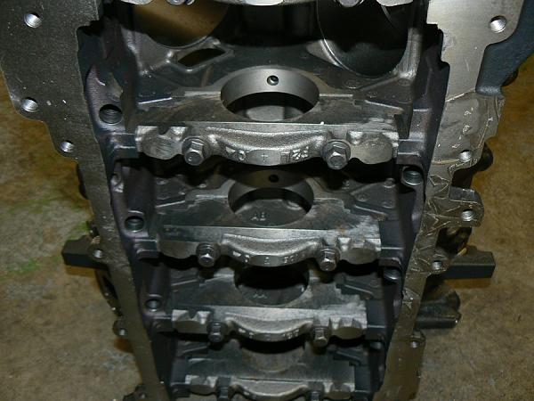

Just fired mine up today. It is a stroker also so it is a bit different. The picture you posted is of a Cammer aluminum block. The Boss50 does NOT have provisions for knock sensors. It DOES need the motor mount adapter brackets. It also DOES need some modifications to the timing cover to prevent it from leaking. Otherwise, it is the absolute strongest modular block you can put into your 3v car!! All costs are similar to building any motor except you will pay more for the block. I am breaking my 326c.i. motor in N/A and then I'll put my Turbohorsepower 76mm on it.
The piston in the bore and the old one in the piston pic is a .020 over std piston for comparison.

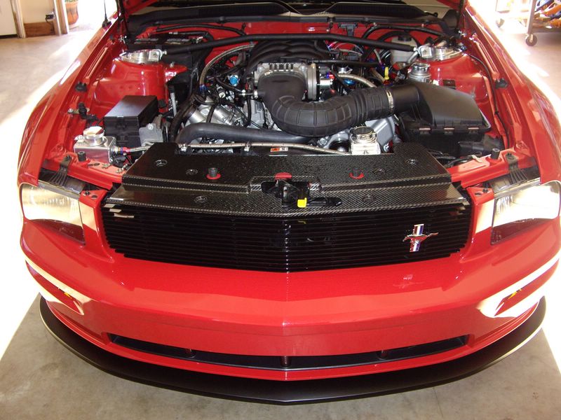

Had to get it out of the garage so I could install somebody's UDP's this weekend. Hehe.
