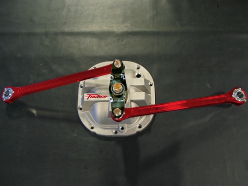

Have you guys seen this watts link..
http://www.techcointl.com/Watts-Link-a/138.htm

Nice find, never seen that before. Must be SMS's new supplier considering the amount of stuff they have from the 25th Anniversary model.
Basically seems like a refinement of the original Saleen design, even includes the anti-roll bar. Same price, too, at least at intro.

They are SMS aftermarket side. I'm thinking about replacing my saleen unit with it. What I really like is the beefier diff cover and spherical bearings instead of bushings on the links.

I belive the fays has options on bushings and type of bushings as well. I will be looking for the spherical ones. Soild and maintenance free.

I'm with you, man. I was just about to order the Saleen / JDM unit until I saw this.

The Techco Watts link looks pretty sweet. They have made a couple changes that aren't in the picture. The bell crank bracket is now a double sheer type. The only problem I have with this unit is that there is no adjustments. It is made for the SMS cars which are only lowered about 3/4". Since I have Steeda springs my car is lowered 1 1/4". I emailed them about this and they said it would work fine. There brackets are very simple and I could probably make some new brackets with additional adjustment holes. I was thinking about using the Griggs unit at first with their torque arm. Now I am wondering if I can use the Griggs Torque arm with the Techco Watts link.
