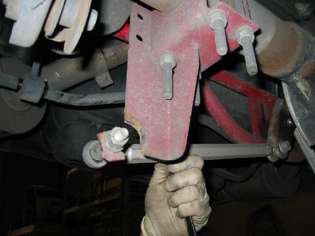

Originally Posted by rony1976
look for the thread with the broken fays... I haven't seen/heard of a saleen breaking as of yet...
It was the Lakewood unit that broke, not the Fays.
