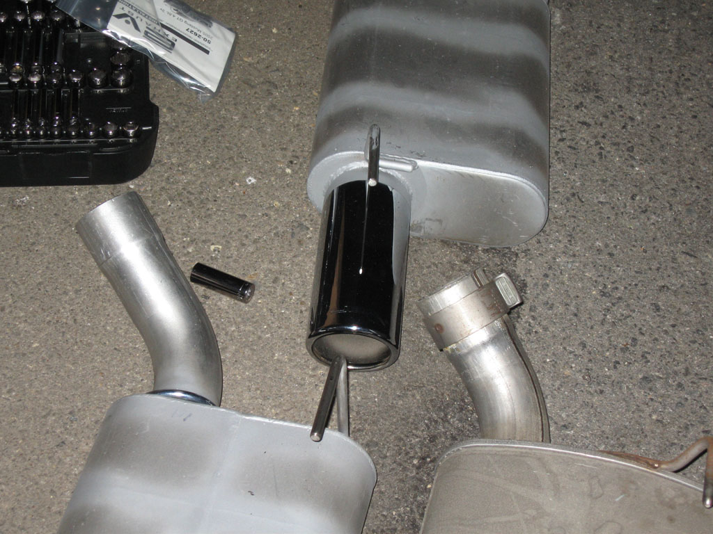

I bought the JBA axle backs on the 24th of June. Here's my experience so far: Installation took about 3 hours. Things went smooth when I realized contrary to the instructions they don't "slide" onto the hangers, the hangers have to be removed. This is because the intake side is over an inch longer than the stock mufflers. This also pushes the muffler back so that it's actually twisted. So I take it to a shop and they end up triming a half inch off the pipe on the drivers side so the JBA will fit. The JBAs aren't slotted like the stock mufflers so the clamps didn't do anything - could still "wiggle" the drivers side even after torquing the clamp. Had the shop go ahead and weld them on. <- That was two days ago. Today I've got a rattle at around 1500 rpms. Maybe something is loose? Hanger? Crawl up underneath and tap around and narrow it down to inside the passenger side muffler..... I pull out the invoice (going to call them tomorrow) and in capital letters at the bottom reads: ALL PARTS ARE SOLD "AS IS" AND JBA OFFERS NO EXPRESS OR IMPLIED WARRANTIES ON PARTS. THE ENTIRE RISK AS TO THE QUALITY AND PERFORMANCE OF THE PARTS IS WITH THE BUYER. - JBA Performance Center.
That's my two cents, I'll keep you updated if you're still considering the JBAs
T

Talked to JBA "Performance". They were friendly, said I would have to go through JBA "Headers" but to bring it by first and let them take a look at it.
Stopped by the shop that did the work last week on the way home and the guy who worked on it said the passender side muffler definitely sounds like somethings broken loose.
Now I've got to break loose from work for a morning to cruise down to San Diego.....
Rondosa - don't get me wrong, I LIKE the JBAs, look and sound (throaty/just somewhat louder than stock). The fit has been an issue. And by that It's become a lot more than a 1 hour install.
T
