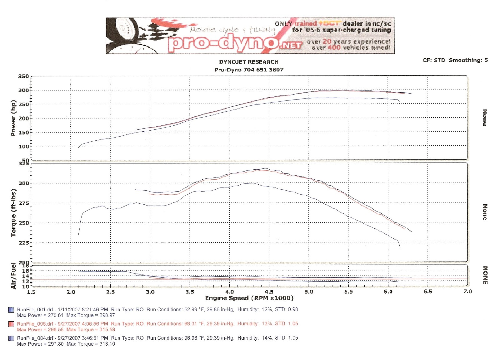

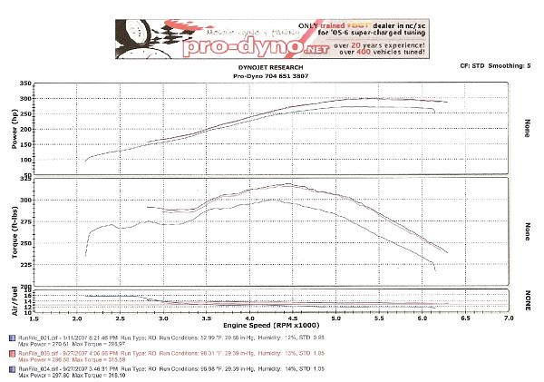

06 Mustang GT Manual
www.pro-dyno.net
Stock numbers: 270.61 hp, 298.97 tq
Steeda CAI and 93 Race Bamachips: 297.80 hp and 318.10
Doug's tune was a little lean, 13.4 under 4k and 13.2 above so we added 4% fuel to get it 12.6 to 12.8.
Conclusion: Steeda CAI and 93 Race Bamachips results in 27 hp and 20 tq.
I was very pleased.

what do you think the hp/torq result would be if it were 91 octane?

Yao, hey my friend, exhaust doesnt do much on these cars. I think going from 93 to 91 would loose no more than 3 hp.

Can you post your graph of your dyno run. I'm interested in seeing the power curves
I'm running very similar numbers with only an exhaust added and I had mine custon dyno tuned. Just goes to show how good Doug's tunes are.
Also, what brand oil are you using. I changed after my tune and my mpg went up which makes me think that I freed up some hp???
