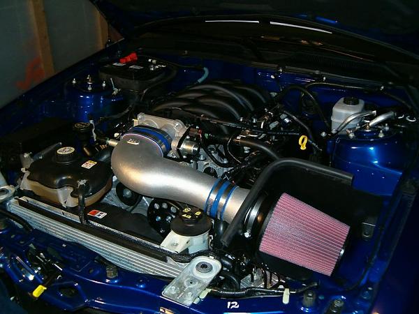

Over the winter I purchased a C&L CIA it came with the Diablosport Predator. Yesterday I finally got to install the C&L CIA and when loading the tune I noticed that I don’t have a selection for the C&L tune just a generic 87, 91, & 93 tune…. I received a disk with the purchase and I noticed that on the Video there was a selection for the C&L tune…. Help… Where do I download the correct C&L tune… My Diablosport model# is U7140
