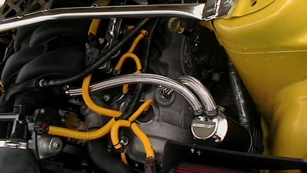

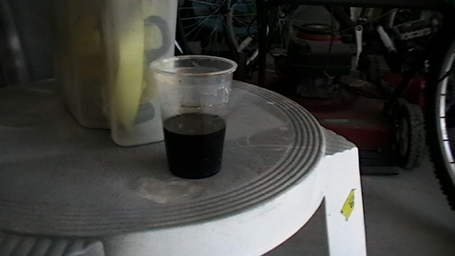

Americanmuscle.com has a good catch can. I run one one the drivers side and it catches a lot of oil. I have considered putting one on the other side. Breathers would just cause oil to get all over your engine bay.
That's a pretty crappy catch can dude. Those things have no filter media inside them, just the empty can. Far from efficient.
I setup my own Separator on my 03 using a can from Stef's Fabrication. Very well designed and no way any oil is getting past that thing. I am contemplating rigging one up for my GT500.

Actually it works very well. And is has a large volume and cooling area. I was running clear tubes on it and had no oil getting past it. The clear tube were ugly especially the one comming from the cam cover (oil in it). The filter is unnessary if it's large enough to cool the blow-by.
