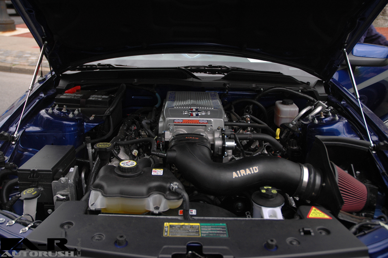

Airaid is another that doesn't require a tune. Plus it looks rather nice under the hood. Check my pics below.

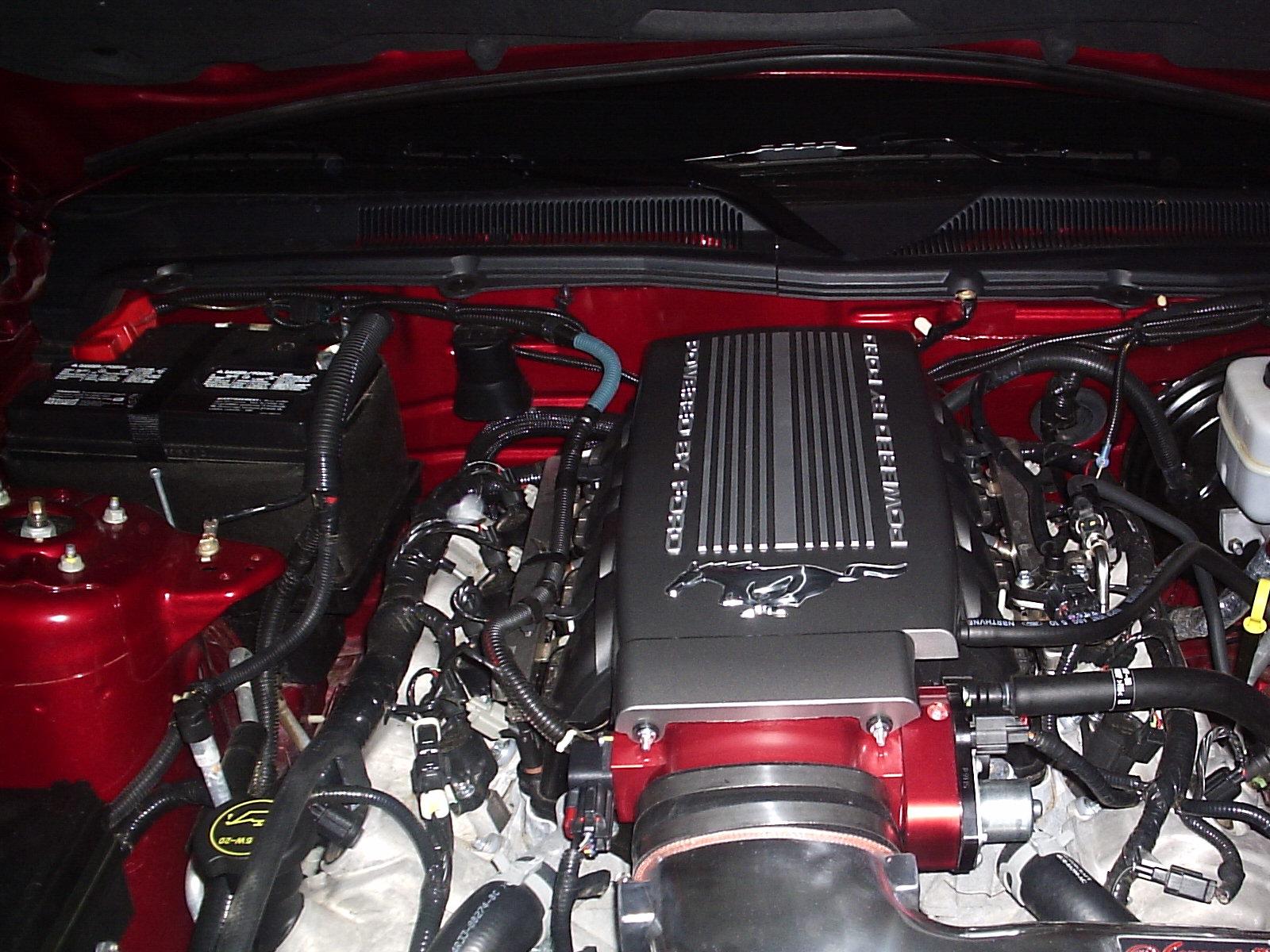

The Granatelli CAI does not require a tune, as they have partnered with Hitachi and adjusted the Mass Air Flow sensor to compensate for the extra flow of their 90mm intake. Hitachi makes the factory Mass Air Flow Sensor. The Granatelli can still be tuned to make even more power, but with just the CAI, several members have made 25 additional horsepower. Attached is a pic of it installed on my 2007 Convertible.

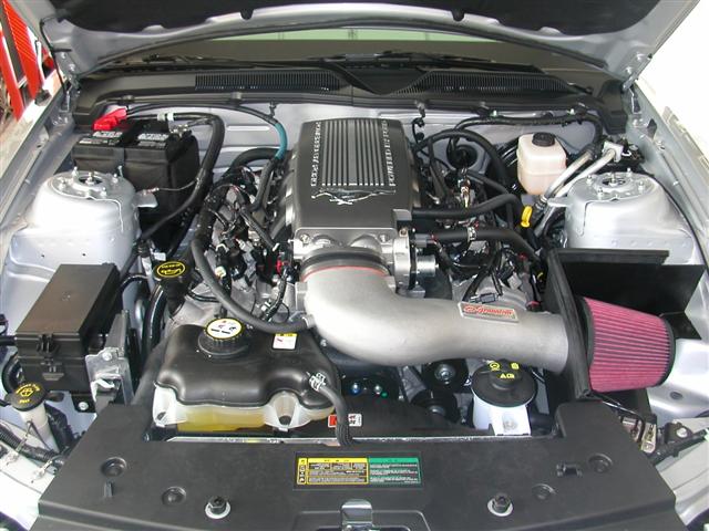

And my 2005 Coupe
