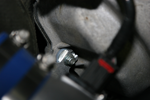

I installed the bracket with the "U" cutout option as visible in my photo.
Just apply 1 hacksaw to bracket and reuse the OEM valve cover bolt.
I don't think it's going anywhere

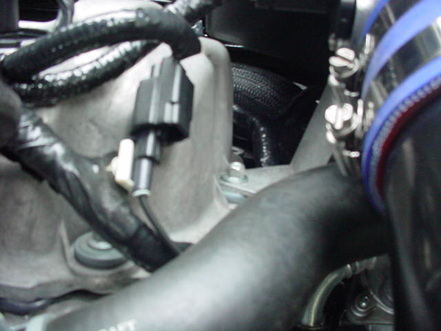

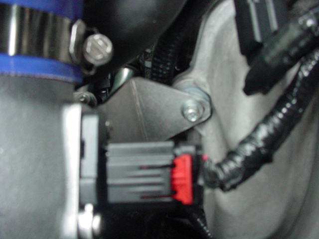

Dr.Q The MAF bracket is a piece of cake to install! the valve cover bolt is no problem to remove! I have removed my CAI a few times for dealer issues and left the bracket on! you would have to be looking for it to see it with the factory air box on! The bracket does add stability to whole unit! plus it does position the CAI in the correct position!
