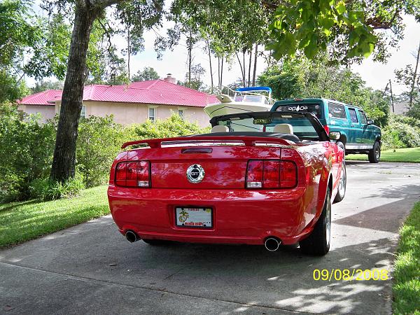

The GTA tip's look a lot better than the Bullitt tips. Not sure if they sound the same as I have only compared them to one Bullitt at work and his wasn't broken in yet (less than 1000 miles).
BB
Semper Fi
