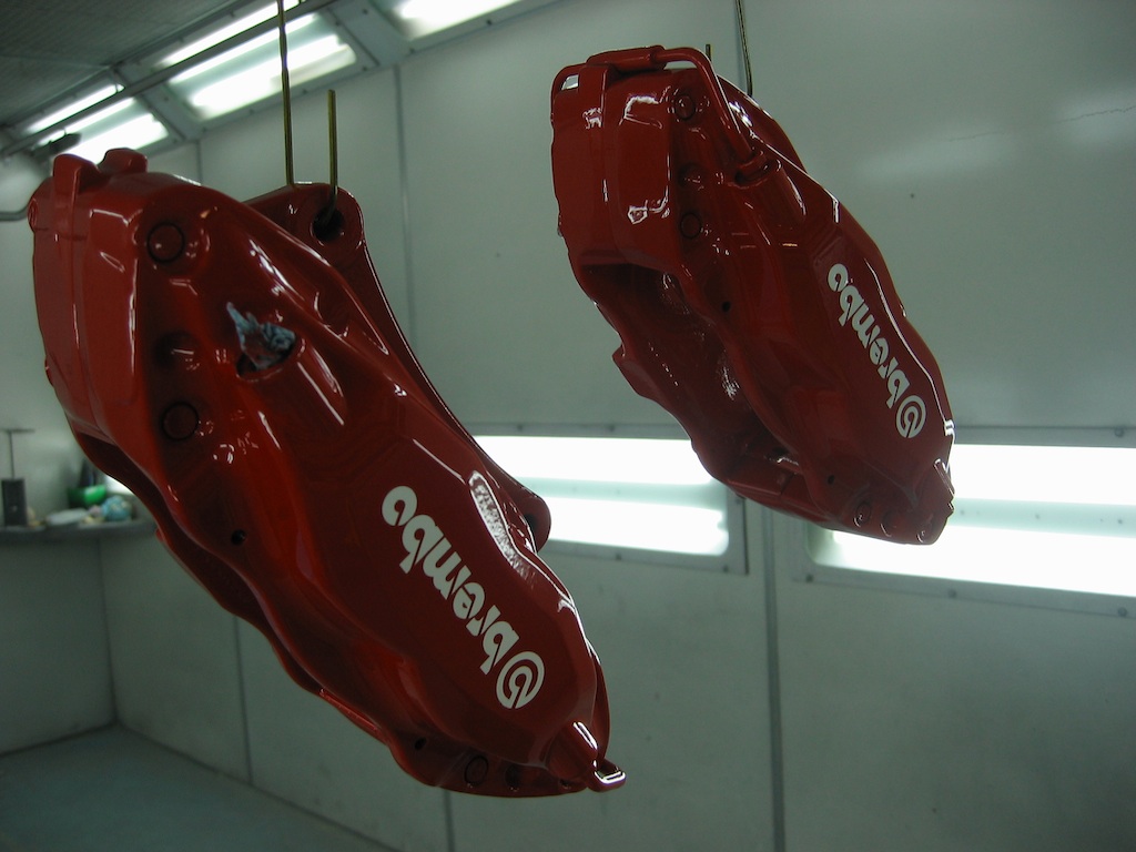

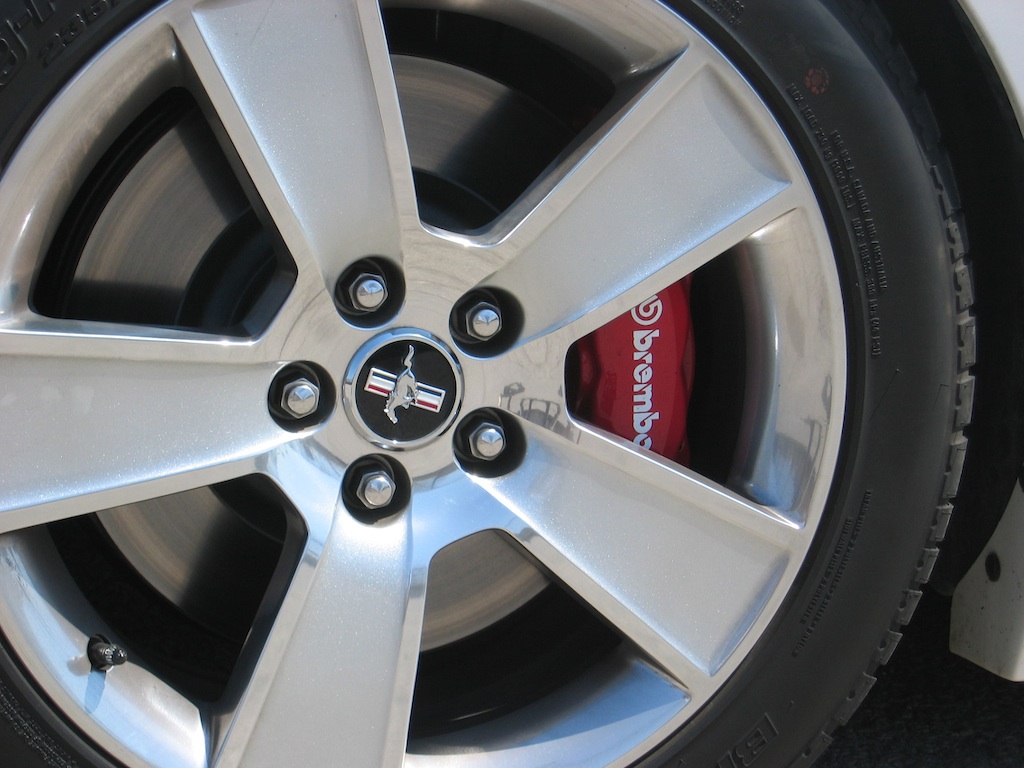

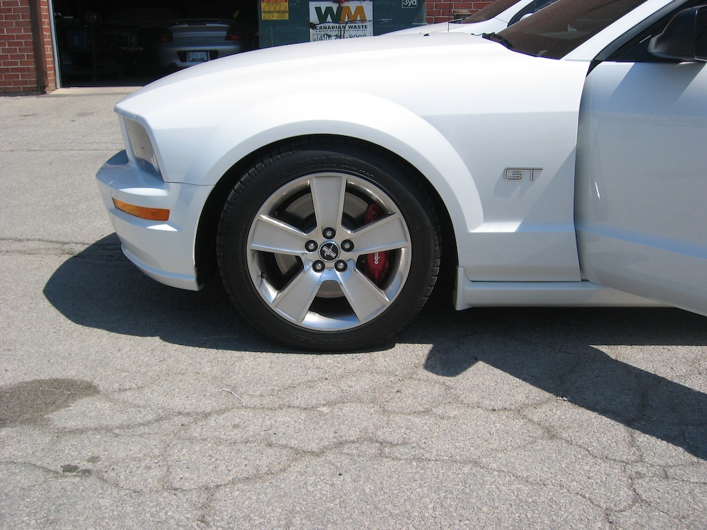

what's wrong with getting some small spacers?
http://forums.bradbarnett.net/showthread.php?t=56056
http://forums.bradbarnett.net/showthread.php?t=64176
Turns out I only needed 1/2" spacer up front to make the GT500 brembos clear under my 18" fanblades. I assume that the 18" bullits would be the same. No spacers would be needed for the GT500 wheels obviously.
Kristina
Attached Thumbnails brake upgrades that fit GT/CS rims-brembos6.jpg   brake upgrades that fit GT/CS rims-brembospaint1.jpg   brake upgrades that fit GT/CS rims-brembos1.jpg
