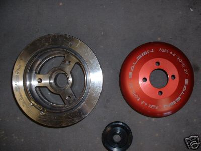

Well I bit the bullet and bought some saleen underdrive pulleys. I got a great deal on a slightly used/demo set with some nicks. I got them for 79 dollars shipped off ebay. I think that is a great deal after looking at pricing around. If anyone has any tips on install please chime in. Will I need to use the same belt, or will I have to install different size belt etc? Just looking for any info on installation. Thanks

Did your pulleys come with any bolts? My Steeda set came with a new alternator bracket bolt (to prevent interference with the belt) and a 60mm (long) crank pulley installation bolt. The latter is just to start the pulley onto the crankshaft. Once it's on you switch back to the shorter factory bolt. I re-used the factory serpentine belt. Let me know if you need any more info.

I bought a used set of Saleen SS UDP's from MM in High Ridge for a $100 and they installed them for a $100. You can use the same belt.

Well I just recieved my kit. Dude actually sent two of the red water pump pulleys, one is brand new and one has a few minor scratches in it. They look pretty good actually. I will try and put them on soon. Will post pics soon as installed.
