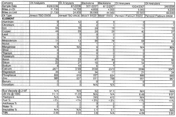

Sorry, I forgot to post this earlier. The first 2 samples were of the Amsoil TSO 0W30, and I think the engine was still in the break in period because I do so much highway driving, so you can sort of disregard those samples. The other samples though are much more meaningful in my opinion.

What's all that small print say? If I wanted to read all that stuff I would go back to college.

Sorry, I should have included an explanation of what that stuff is. The numbers for the different metals and elements are the wear metals in parts per million in the oil. Lower numbers are better, obviously. Normal ranges differ depending on the engine make/version.
The important part of this chart are the top 5 metals listed in the chart. Those are the main wear metals. The rest like calcium and molybdenum are additves to the engine oil. The bottom part of the chart lists the physical properties of the oil, showing what condition it is in.
The TBN is also important, it is the Total Base Number. It shows the amount of active additive left in the oil to combat the acids produced during combustion in the cylinders. As fuel is burned, acidic compounds form and get into the oil. Left unchecked, these acids can eat away at metal and cause increased wear on parts. Oil has additives to combat these acids, and the TBN tests that. Anything below 1.5 and it is time to change the oil. Fresh oil starts out around 8-10.
In a nutshell, it shows 5W30 produced lower wear metals than 5W20 in my engine on two occasions. 5W30 Mobil1 was lower than 5W20 Mobil1, and 5W30 Pennzoil Platinum was lower than 5W20 Platinum. I'm sold on 5W30.
