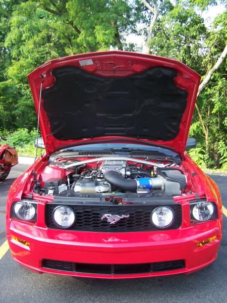

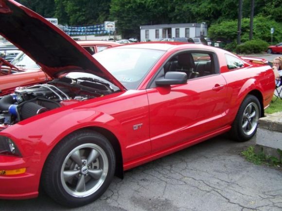

Charlie, I can't say for certain as to whether the Boss 302 brace will clear or not with the plenum cover.. However I can confirm the STB for the 2008-09 Bulliit models will clear both the hood and plenum covers for all 2005-09 models..
I still have the Ford Racing STB that was installed on my old 2005 GT which is exactly the same as the Bullitt STB that fits all 2005-09 V6, GT and GT/CS models.. In the meantime, here's some images of the FRPP STB on my previous 05 GT with plenum cover.. FPP part #M-20201-F..

Charlie, the Ford Racing STB cleared both the plenum cover and hood liner perfectly with no issues.. As I mentioned previously, it's the very same STB that was factory installed on the 08-09 Bullitt, but without the Bullitt name plate and serial number and is also the very same STB for the V6 model as well.. I did extensive with Ford Racing to make certain the STB for the Bullitt and V6 were both one in the same before purchasing it..
