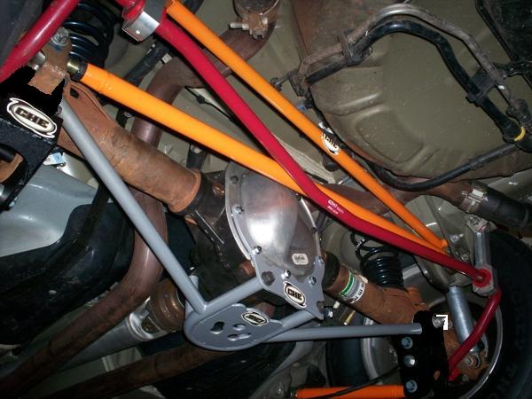

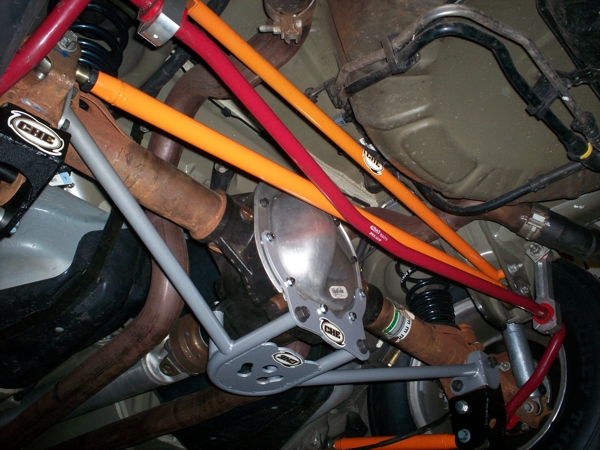

I think adjustable LCA are too much trouble. I agree with 07 GT/CS. If you need to adjust pinion angle just go with an adjustable UCA. Unless you are going with an agressive drop or switching to a one piece drive shaft your pinion angle will not be too bad. I also agree that level or slightly lower in the rear on the LCA is the way to go. If I had a ton of horse power and running slicks I would research how much lower to drop the rear of the LCA. There is some point where your torque is lifting the body of the car more than it;s pushing it forward.
07 GT/CS: have you seen the axle truss that CHE makes? I am thinking about getting that and the relocation brackets. The truss bolts to the factory control arms brackets on the axle housing. I would cut the mounting points off the axle truss where they bolt onto the factory LCA brackets, use the CHE relocation brackets as a template to make new ones that cover all of the factory bracket and weld them to the axle truss where they would gave been. Then weld the whole thing in as one whole piece. Don't know if that's all confusing or not. If you look at the pic you can see where the gray axle brace meets the black relocation brackets. Just imagine that where the two but together they were actually one piece. After seeing pictures of some of the relocation brackets that have bent under hard dumps of the clutch, I think the beefier the better. Overkill is better than repairing something if it does give way.
Sorry to highjack the thread. Just trying to improve on what I think is still a weak link.

chuckieduck's Avatar
Joined: August 24, 2008
Posts: 41
From: Chesapeake, Va.
Forgot to attach pictures. One picture shows the relocation brackets and the axle truss as two different pieces. The other picture shows how I want both pieces combined and even extended orpund the stock piece even more.

Chuckieduck, I did see that setup on the CHE website. The only thing I'm not fond of is bolting stuff to my diff cover. I do a lot of off-roading and there are numerous diff skid covers that either bolt to the outside of the diff cover, or even have a complete ring that goes around inside and underneath the edge of the diff cover. I just worry that eventually any twisting at all is going to cause a diff cover leak problem. If I was going to go with an axle truss, I'd be inclined to find one that bolts on either side of the axle tube right against the pumpkin with collars or go underneath the pumpkin without bolting to the diff cover and attach on each side as the CHE one does.
