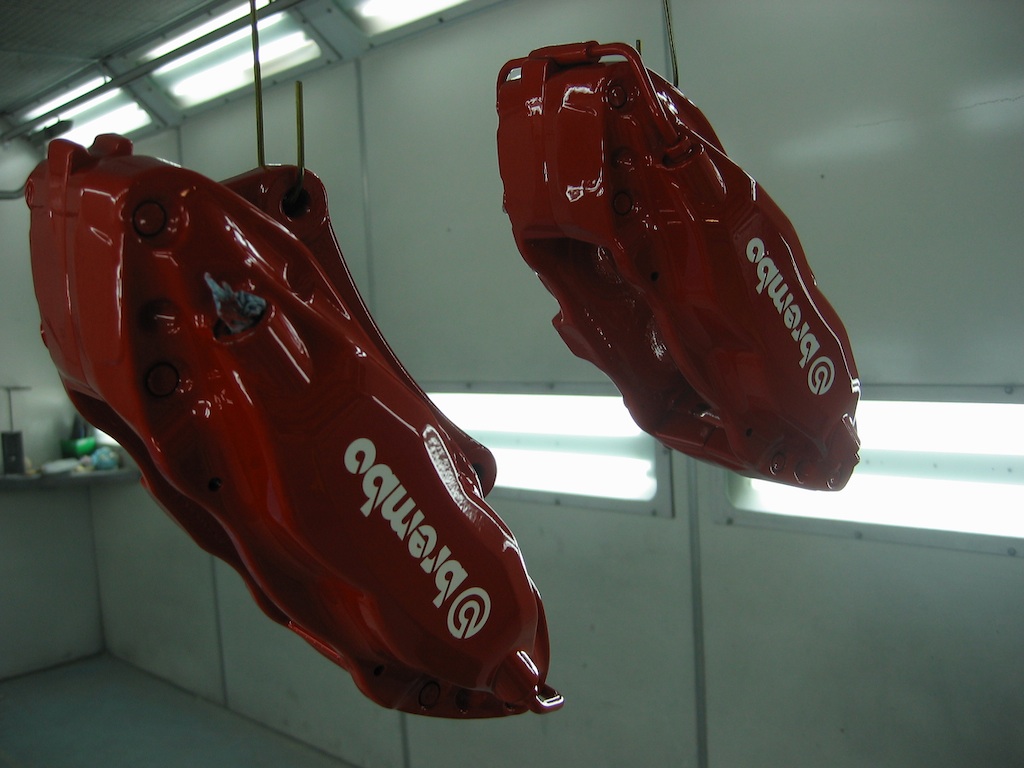

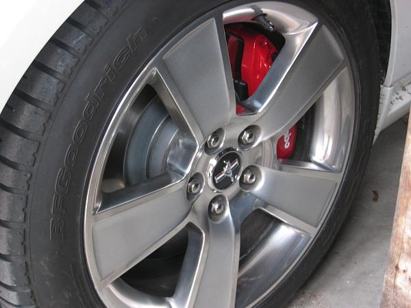

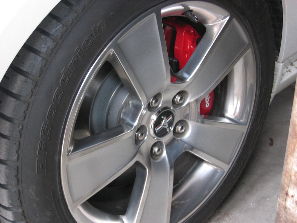

Just finished installing (actually, re-installing) my GT500 brembos yesterday after having them painted. We ran into some problems with slight leaks from each of the calipers where the banjo bolts conntect to the caliper (the calipers use the OEM lines and bolts). Went out and got new copper washers but the problem persisted so I looked up the torque spec to get a difinitive answer and apparently it's 70nm or 52lb.ft torque. You wouldn't think that a small bolt like that could carry that much pressure without snapping but apparently it does because that solved the problem. Other then the washers, I didn't need to get any new parts. Got the copper washers at a local automotive supply store, I bet the dealer can get them for you as well.
To bleed the system, we used a pressure bleeder to make the job easier - nothing special there - hook it up to the brake resevoir, ensure there's a proper seal, pump it up to approx 7-10psi (we started with 7 and needed a little extra) and start at the passenger side rear. As always, make sure you have some brake cleaner on hand to get rid of any brake fluid residue. We filled up the resevoir a bit before we got started - maybe 250ml or so - though with the amount that came out we didn't risk it running dry. With a complete flush, it's a different story. After one go around, we went back for a second pass just to be sure. Having someone pump the brakes, while more time consuming, works almost as well.
Hope that helps a bit.
Edit: I used ATE Brake Fluid, DOT4. So far so good, it's only been a day.
ps - check out my calipers, black was nice but the red looks amazing!
