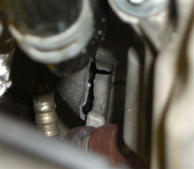

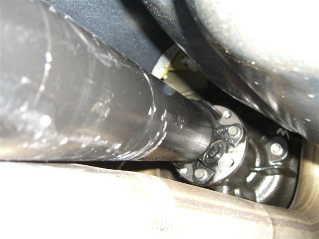

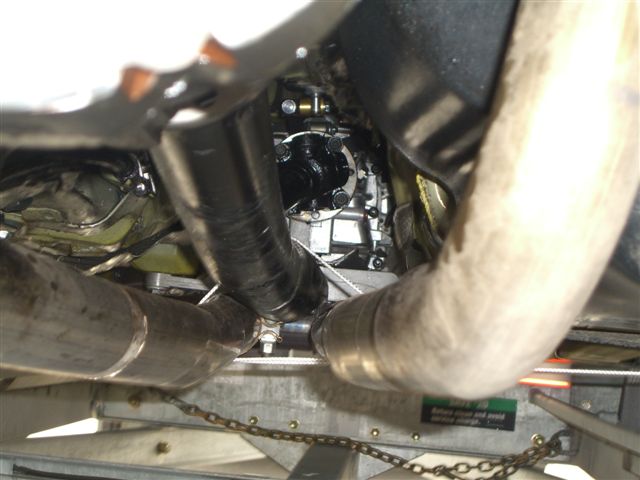

Finally pics, the car has not been put up on a lift yet so these are just ones I was able to take with the car on the trailer...
As you can see it cracked the transmission wide open, the d/s appears to have broke at the yoke (I think its called - where the larger part of the d/s meets the smaller diameter portion that attaches to the transmission).
The tunnel was beat up enough that it bent both rails that the seats slide on so both seats have difficulty moving. We'll see tomorrow what a general estimate looks like.

Wow! That's the first aluminum driveshaft that I've seen break. You're definitely going to need a new transmission with that big crack on the side of the housing. I think the fact that it broke in the middle actually caused less damge than if it would broken at one end. If it was installed incorectly, which seems to be the case if it was vibrating and had been balanced beforehand, then the shop should pay for the repairs. Is your car lowered at all?
