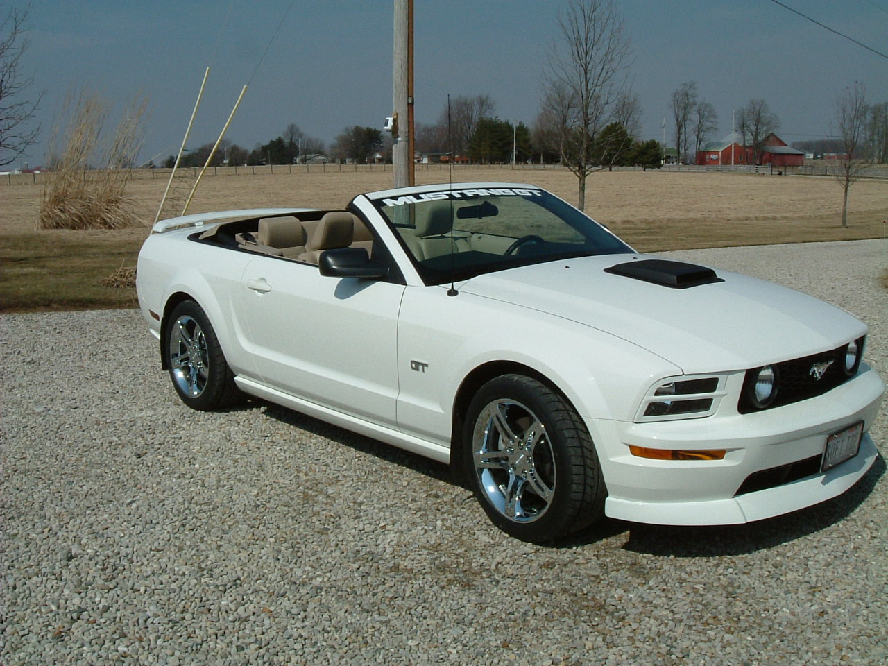

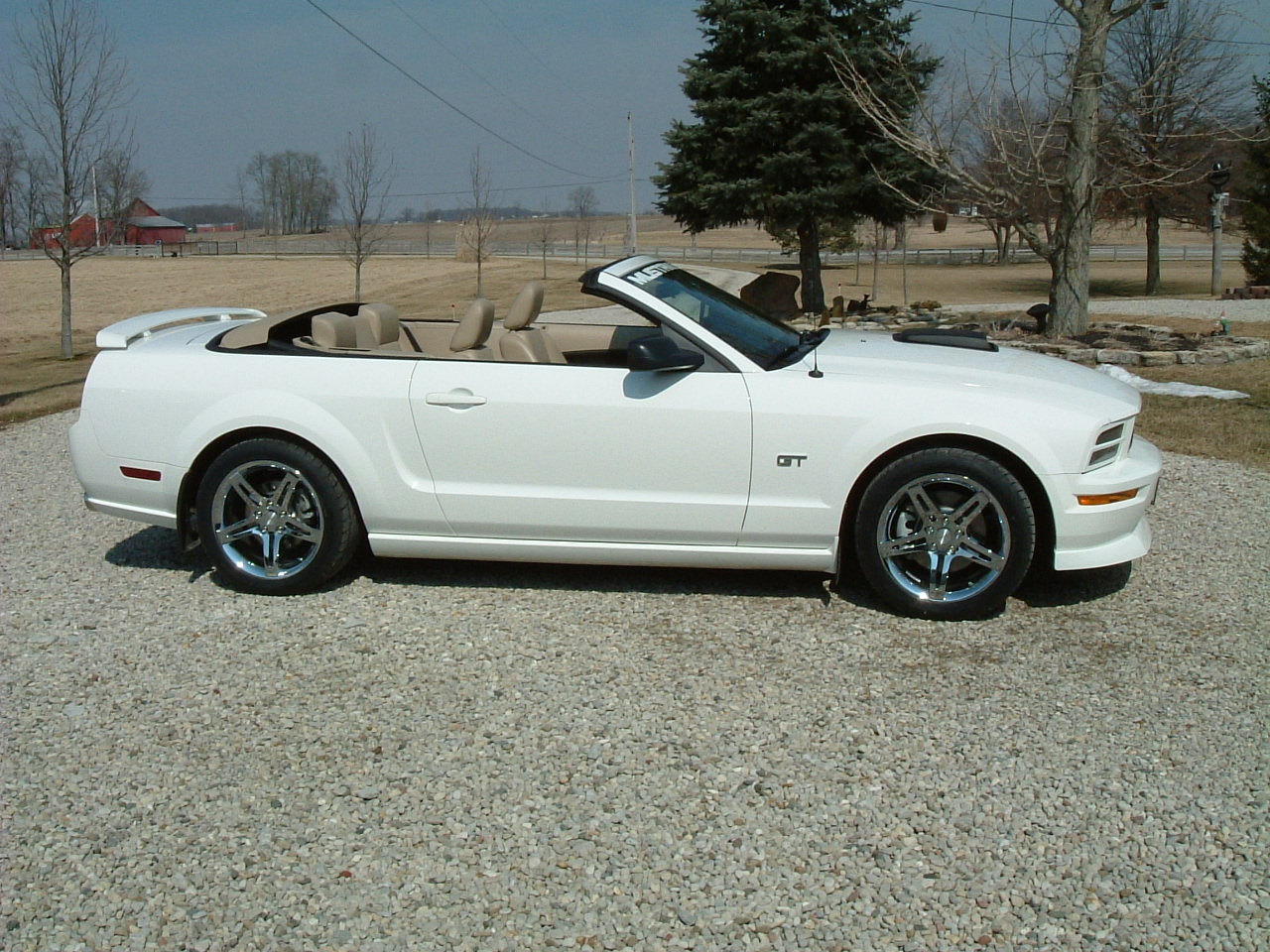

Hey John,
Your facts about the spring rates between verts and coupes is interesting. I always thought my vert looked like it sat lower than coupes ( without my chub azz in it) and thats is why I never felt I needed to lower it. Here's a pic.
Scott

Well John, from the photo's 70MACH1OWNER provided and others I've looked at the verts do have a lower ride hight and what looks to be less rake! PS: I see you live Oregon! I lived in the Beaverton and SE Portland ( Mt.Tabor) area for eight years before moving back to the land of Corn and Soybean!......I do miss the Pacific Northwest!!!
