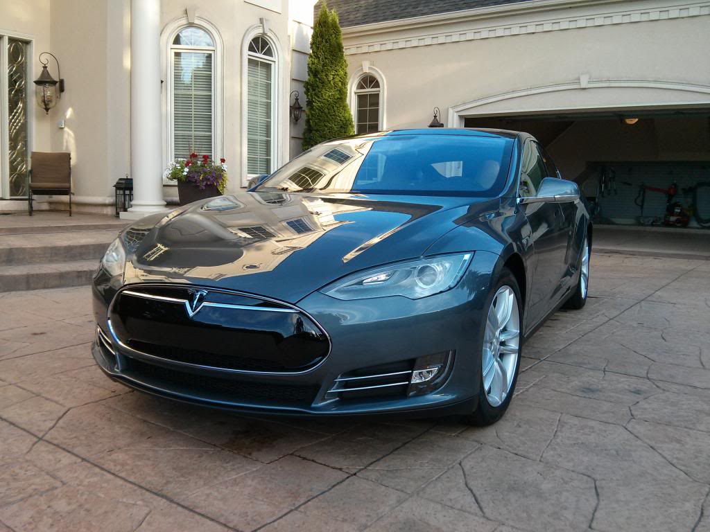

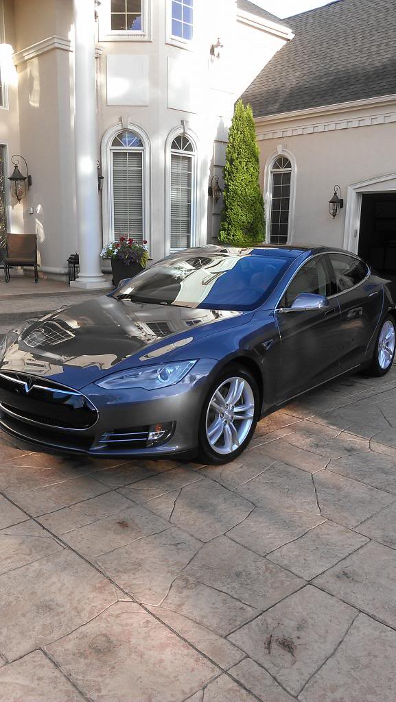

The first car was a beautiful grey Model S. Working together, Marc and I washed, IronX'd, and prepped this car for a light polish and Opti Coat Pro application.

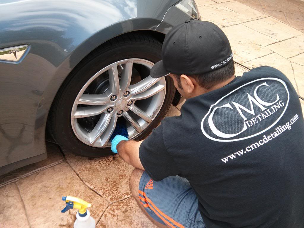

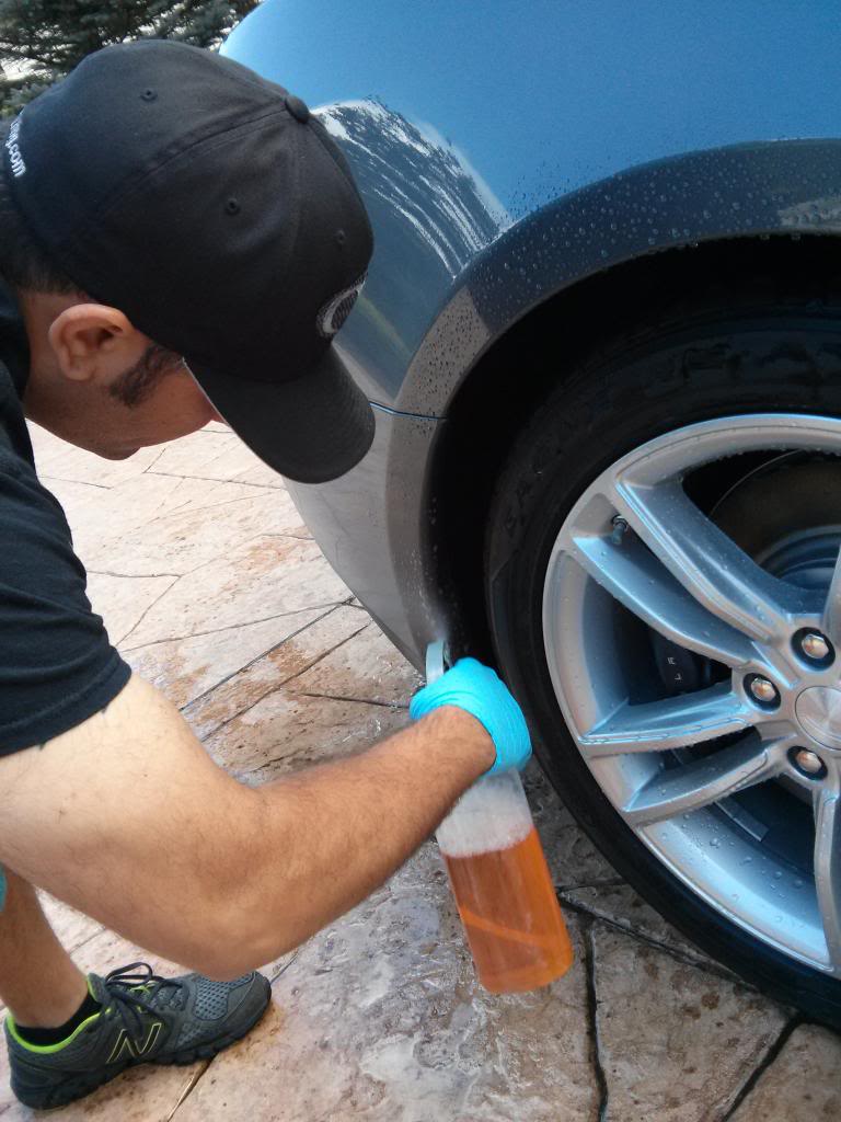

We started by cleaning the wheels and tires.

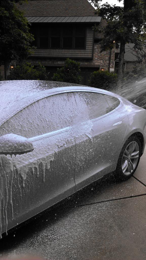

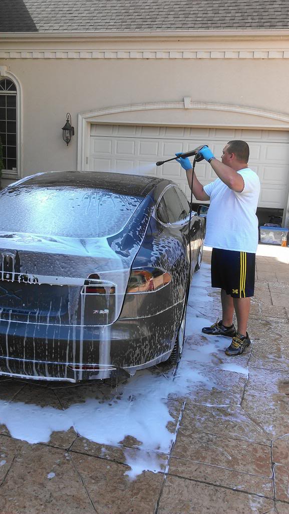

Marc then foamed the car down prior to washing, to break down remaining waxes and also lift off heavier debris.*
After foaming, the car was rinsed, hand-washed carefully, and rinsed again.

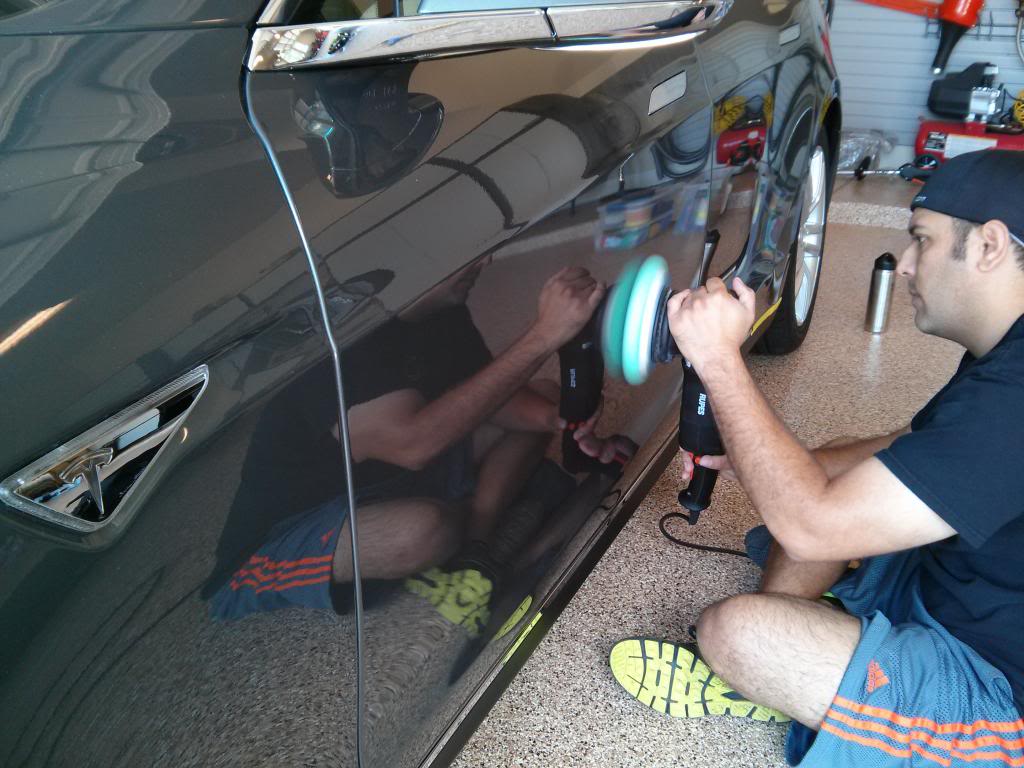

Here I'm polishing with HD Advanced Polish on a Buff and Shine green pad with the Rupes 21. This light combo was perfect for this particular paint.

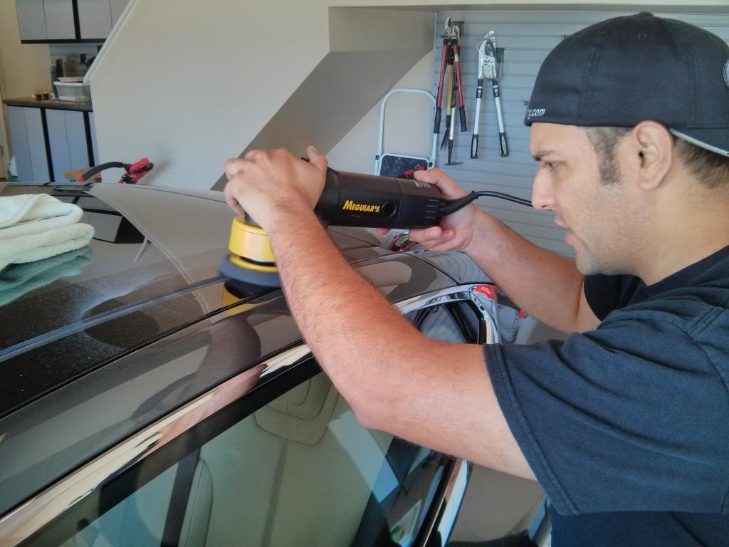

The pillars were much softer, so a black B&S pad was used here.

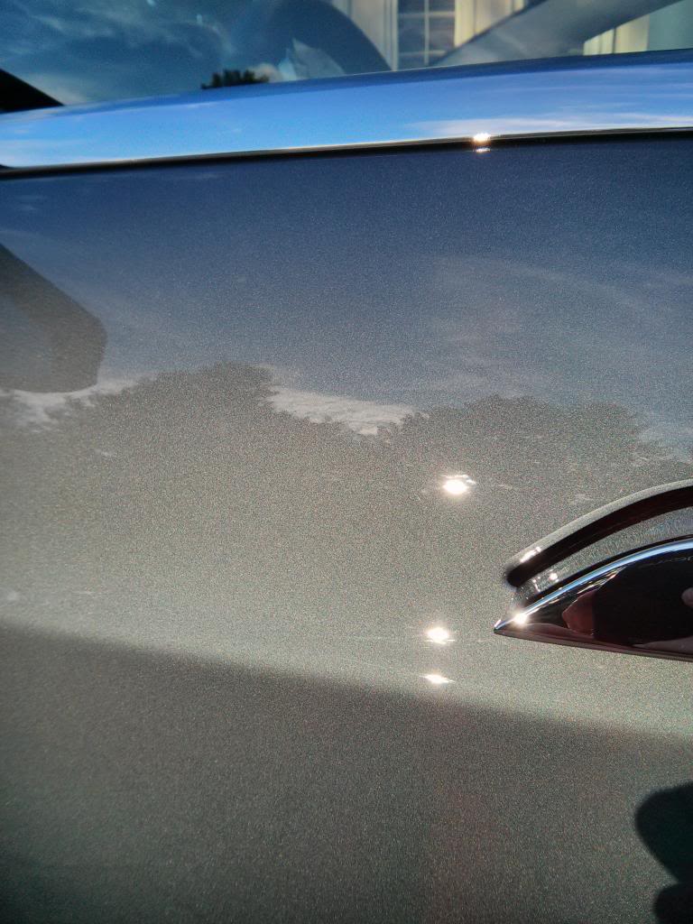

No swirls!!

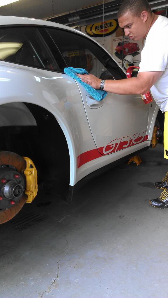

After this Tesla, Marc and I worked to prep a Porsche GT3 RS for the Concours D'Elegance of America at St. John's. This beautiful car received a thorough cleaning and light polishing to get it ready.

Marc doing a final wipedown with Dodo Juice Red Mist Tropical

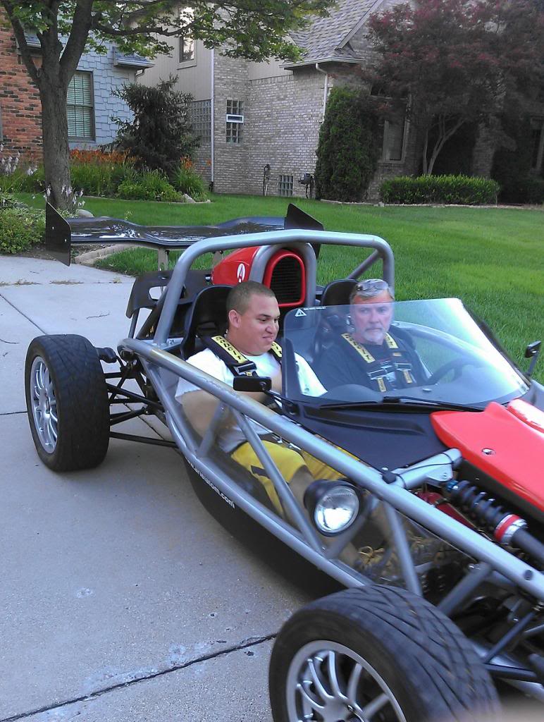

Afterward, the owner took each of us for a spin in his Ariel Atom. To say this was an intense ride would be beyond understatement. It probably took years off my life...

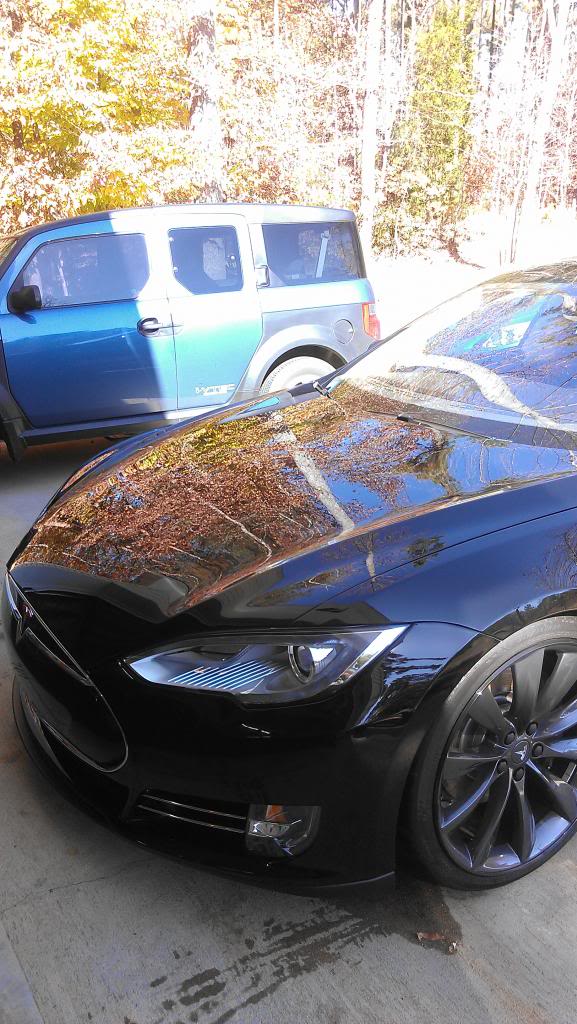

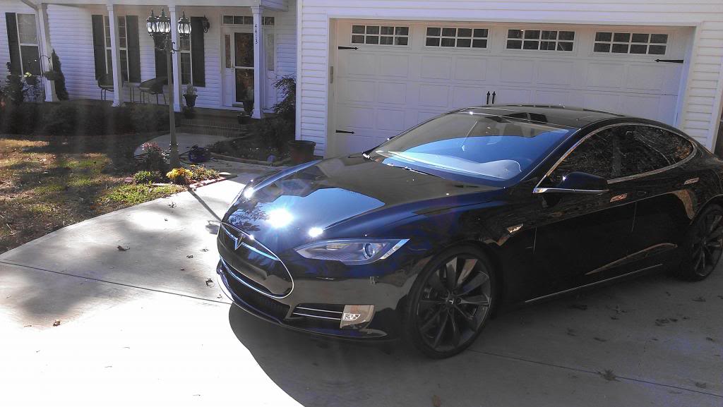

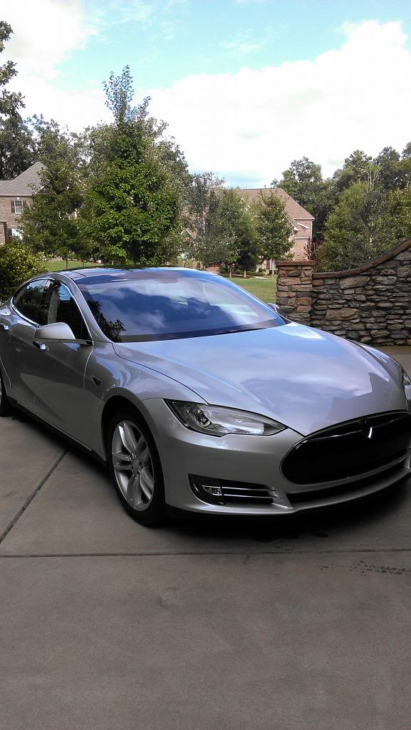

Once I returned to Charlotte, I had another couple of Teslas wanting polishing and Opti-Coat Pro. One silver and one black, these couldn't be more polar opposites as far as condition. Factory sanding marks were everywhere on the black one, most under the clear where polishing can't fix them. The silver one had a couple in the clear, but those were easily remedied.*

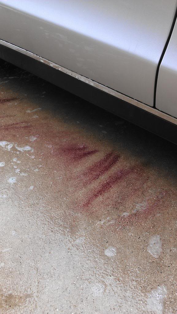

Here you can see the IronX runoff after it has dissolved the iron contaminants in the car's paint.

yes thanks for posting. How long do you let the foam sit on the car before you rinse?

Thanks. The foam tends to run off on its own, once it's barely clinging I'll begin to rinse.

The pic with the red iron contamination is very interesting. I wonder how my cars would fare in that instance? It would look like a crime scene. Lol
