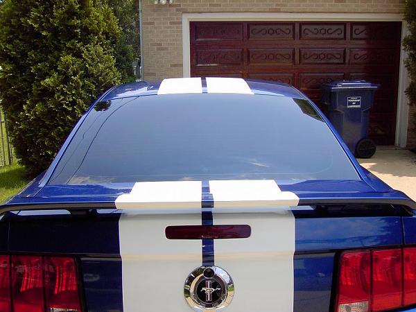

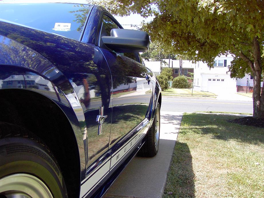

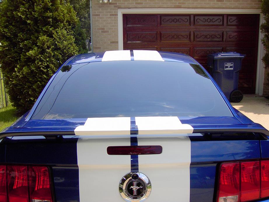

+1 on the Zaino, but I have some extra advice. First I have found Scratch X to be pretty useless, for me I always just used a coat or 2 of Zaino to fill in any minor surface scratches. Though be advised this is only a temp fix and does not get rid of the scratches, it just hides them. which to me is better then getting a buffer and trying to remove them with abrasives. For serious scuffs I use ZPC. Also I would ask yourself how the scratches got there? As filling in/removing is only worth it if your not going to make more.
I use a soft cotton wash mit, I clay bar the car every 4 to 5 washes, and the best thing to do also is use a complete system. If your going to use Zaino use all zaino products, the same goes for Meguires. Also I use 100% cotton towels (made in the
) to dry the windows, plastics and glass with. I also use a chamois towel to do the body and dab dry the water droplets. I found that even if there is slight water lines after dab drying the car they always evaporate and never leave water spots (I dry in my garage).
Though I also highly recommend drive drying and using a leaf blower. After 3 coats of Zaino the scratches were filled in and after testing different towels these were what I found to work best. I think my pics speak for themselves.
) to dry the windows, plastics and glass with. I also use a chamois towel to do the body and dab dry the water droplets. I found that even if there is slight water lines after dab drying the car they always evaporate and never leave water spots (I dry in my garage). Though I also highly recommend drive drying and using a leaf blower. After 3 coats of Zaino the scratches were filled in and after testing different towels these were what I found to work best. I think my pics speak for themselves.
