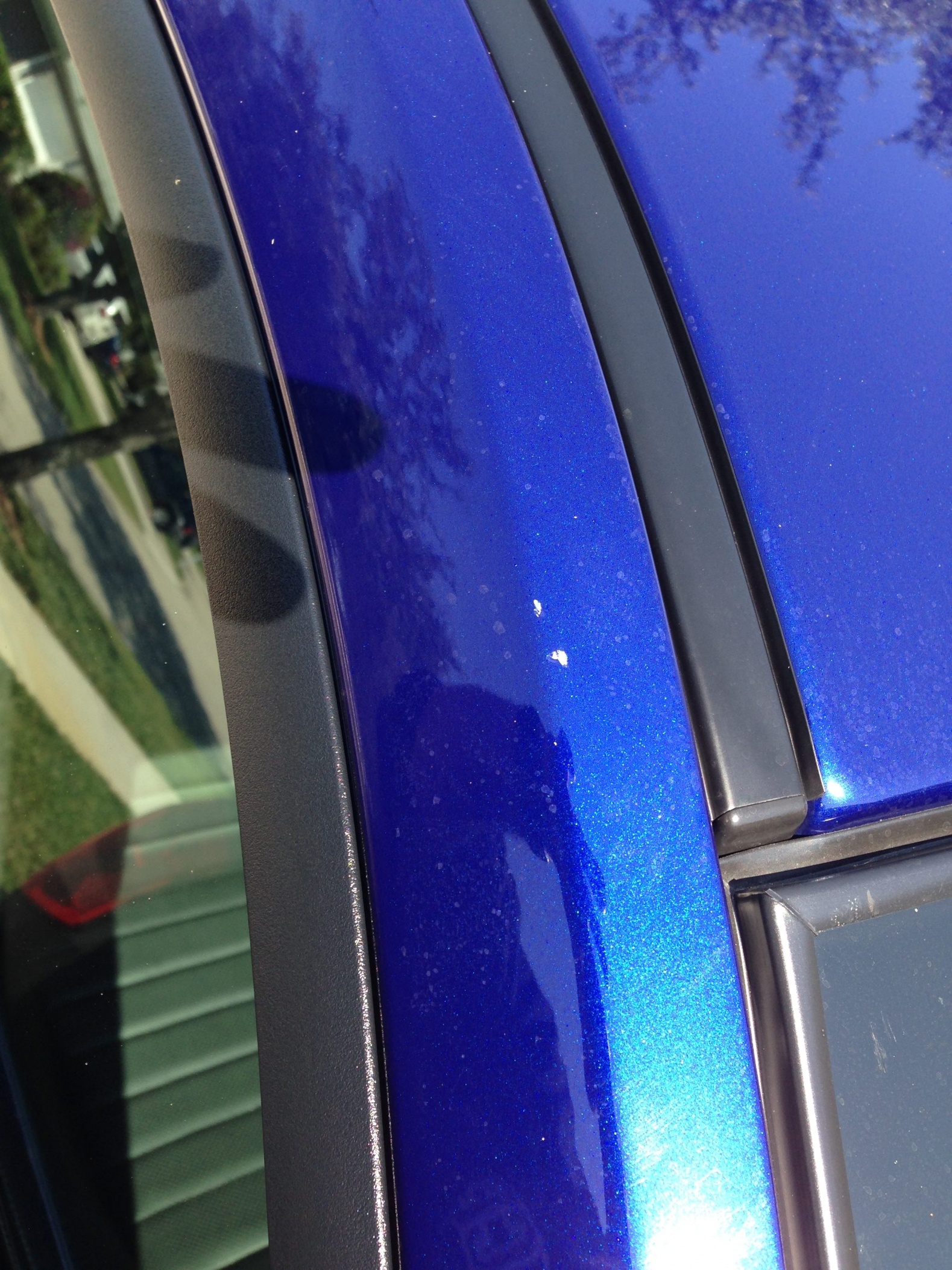

No luck! My first road trip, Florida turnpike, to visit dad before Father's Day, and a construction truck threw a stone which hit my 2014 GT. I couldn't believe it when I heard the excruciatingly horrible sound! Then when I was inside my dad's home they decided to check the water sprinklers in his area. They dowsed my car with hard water leaving mega-water marks in the hot sun. I'll post a couple of pictures of the stone damage. so, if anyone has advice on how to fix these problems I'd be grateful. The car isn't even a month old yet.

Yes, I do understand this. I just was hoping it would not have happened quite this soon. And I'd like some advice on the best way to fix the chips in the paint. One is through the clear coat and fairly deep. I should have done a search before posting. Thanks anyway.

With all the metallic in the paint I would imagine a shop would need to re-shoot the whole panel. Since it's on the pillar it shouldn't cost too much to have it repainted.

cheapest solution would be dr chip. once u do it, u will hardly notice it.

Thanks. I was afraid this would be the case. It is small, but to fix it right I'd need the whole A pillar painted. I don't want to repaint my car every time I get a nick in the paint. But this one is very noticeable on the passengers side. And I don't want to start a rust spot.

Those can be touched up. Dr . Colorchip.

just look up your color code. if i remember correct it should be J4.

LIttle bit of touch-up paint and done. You'll be the only one to ever notice it .. until you forget about it too ...
I was washing my car few weeks ago. I put the hood up while I had the wiper blades up ... OMG .. scratched the heck out of my hood edge. I was really mad at myself. I touched up the edge with the OEM touch-up paint from dealer .. and the defect is now impossible to see.

I have also had excellent results with dr color chip. I think I ordered the silver pkg which came with the paint, pre paint solution, mf cloths, brushes, etc. and it's been more than enough. So I'll have more for future issues.
I also have DIB and the match was perfect.

You basically have several options:
1.) Dr. Colorchip - will put color in the chip and reduce visibility of the chip, but will leave the crater. Best for small chips and "road rash". Doesn't work well with larger chips as the crater is easily visible. Extremely easy to use.
2.) Langka - will fill the chip with paint and with some practice will allow you to get a decent fill/level. Is better with moderate to large chips. Similar to wet sanding but much safer/easier. Easy to use.
3.) Wet sanding (a process of filling the chip and then sanding it down level with the surrounding paint). You can get very good results, but is also much, much harder to do without damaging your paint by over sanding.
However, none of these methods are going to produce perfect results. Especially with metallic paint as the metallic bits will never lay down in a similar pattern to that which is achieved with a spray gun.
I would suggest trying either langka or finding a detailer that will wet sand for you for a reasonable cost (I have a guy that does it for about $50). If you're very motivated and want to learn to wet sand, you'll want to go to a junk yard and find something to practice on.
If you want "perfect" results, you'll have to get it repainted.
