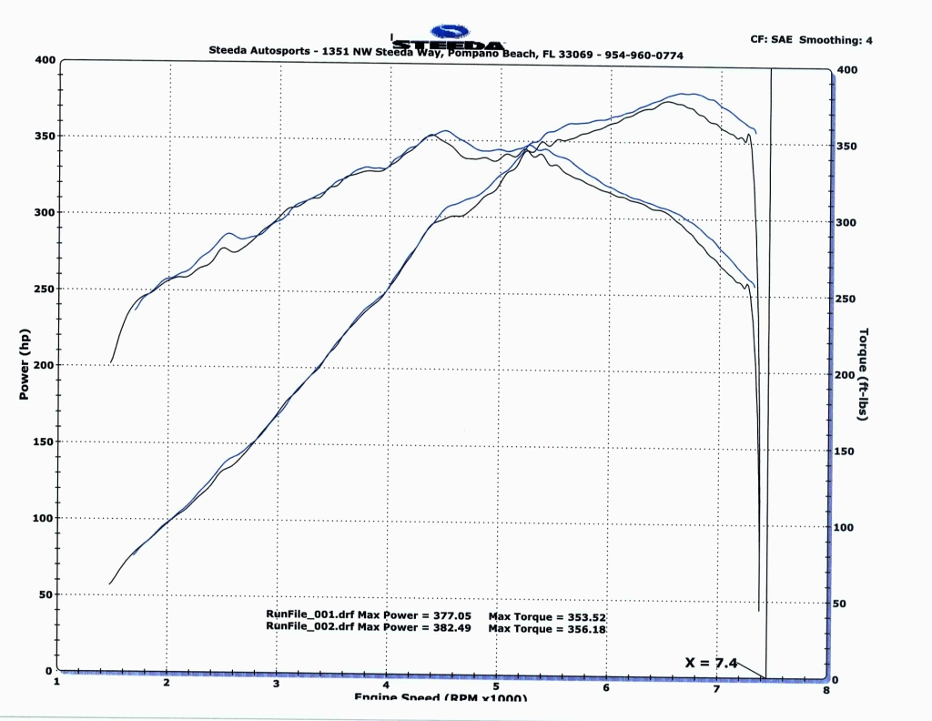

Scuba-Matt,
On this test the car was loaded with a basic tune with no cam timing changes just so we could have a higher rev limiter that way we could rev the engine to the same RPM with both intakes without running into a limiter. Ignition timing was the same for both tunes.
The results show a “peak” gain of only 5 horsepower, but there is a lot more there if you read the dyno sheet. Gains started at about 4,500, with gains of 6 to 9 horsepower between 4,500 and 5,000. Between 5,300 and 6,100 gains were 7 to 10 horsepower. And between 6,700 and 7,200 the gains were an impressive 12 to 15 horsepower. So you can see measureable gains from a cold air intake.
Now what they could come back at you with is how some people don’t see any difference in ¼ mile time. With this power increase in a car weighing 3700 to 3800 pounds with the driver you would be lucky to measure a 10th of a second. This is because the driver alone could loose a 10th of a second just from pass to pass so relying on seeing that 10th of a second is a shot in the dark at best. These are not the days of the Fox body Mustang where a 3100lb car including the driver would see a tenth of a second from just 5 or 6 horsepower. These are heavier cars and that makes a huge difference.
What you can go on is ¼ mile trap speed. With a cold air intake trap speed should go up slightly with the increase in power assuming no gears are missed and the shift points take advantage of the extra upper RPM power. That is how you will see the results of a cold air intake at the drag strip.
