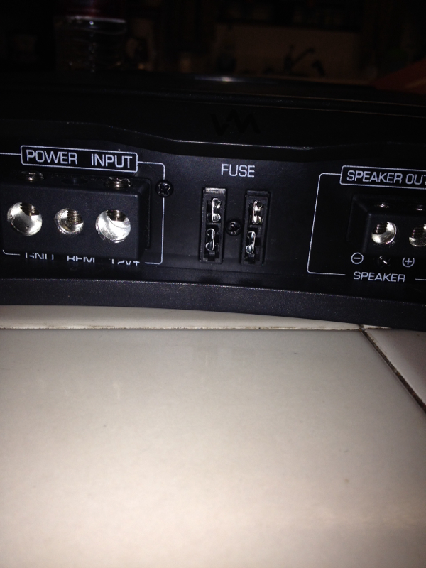

What size fuses do I need to insert into these slots? It's a 1500 watt VM Audio amp. Sra1500 My power wire also has a fuse in it. Does this "replace" those two? I'm confused.

Old Mar 29, 2014 | 10:14 PM
Blue Notch's Avatar
Joined: December 5, 2006
Posts: 31,454
Likes: 71
From: Trapped in Minnesota
According to their site, it takes two 20A fuses. You'll need both these and the one for the power wire.

Old Mar 29, 2014 | 11:51 PM
izaacrudd's Avatar
Joined: March 16, 2014
Posts: 62
According to their site, it takes two 20A fuses. You'll need both these and the one for the power wire. http://www.vmaudio.com/?product=sra1500-1
Yes! Thanks Man !

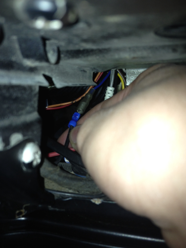

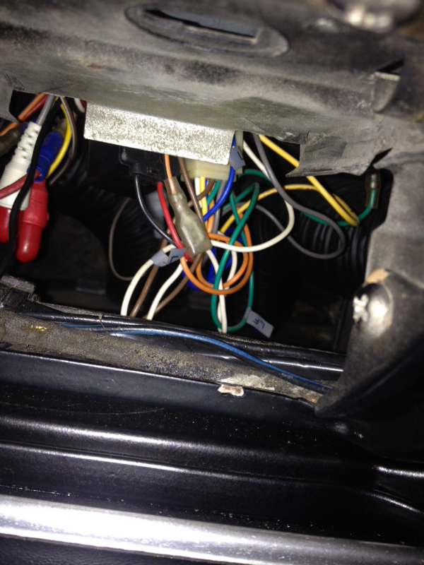

Which is the Remote wire? It's an aftermarket stereo made to look original. Also, my right door speaker turns on but doesn't make sound. If you touch the speaker and turn the radio on, you can feel it turn on but no audio.

Old Mar 30, 2014 | 12:15 AM
Blue Notch's Avatar
Posts: 31,454
Likes: 71
It's usually blue. Do you have the manual?
Old Mar 30, 2014 | 12:16 AM
izaacrudd's Avatar
Posts: 62
No, my grandfather gave me the car and didn't give me the manual
Old Apr 4, 2014 | 03:52 AM
GottaHaveIt's Avatar
Joined: January 5, 2005
Posts: 13,223
You should be able to look up the deck and maybe say try to look up a wire harness plug for it that will show you what wire is what , my son Nate had the same issue & it's how he resolved it.
Old Apr 4, 2014 | 08:12 PM
izaacrudd's Avatar
Posts: 62
I hooked the remote to a fuse that turns on and off with the key. Love it now!
