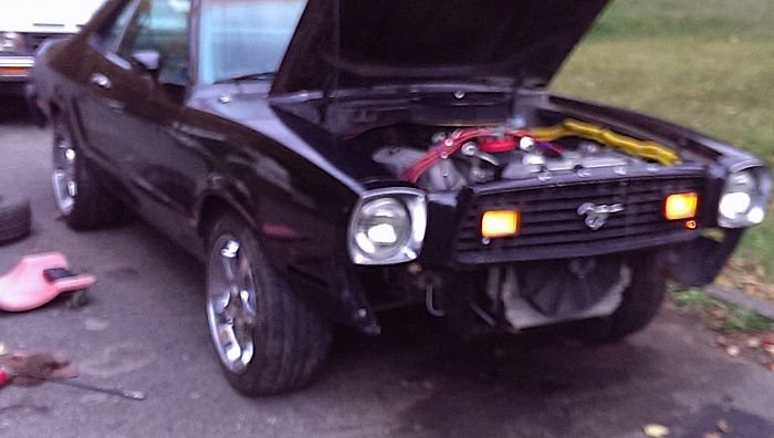

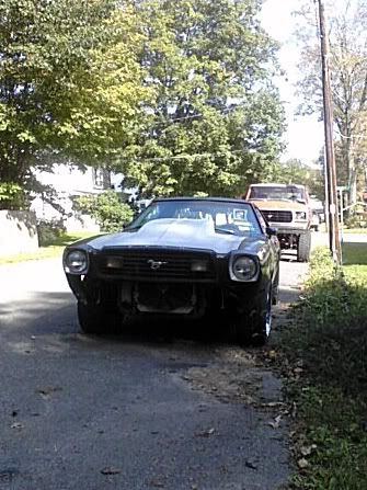

Hello, I just joined up. I've had the same '77 V8 Mustang II coupe since 1988. It's steadily gotten quicker over the years. I built it for road course racing, but it's still just a street car. The car is surprisingly gentle and well mannered as long as I'm light on the throttle.

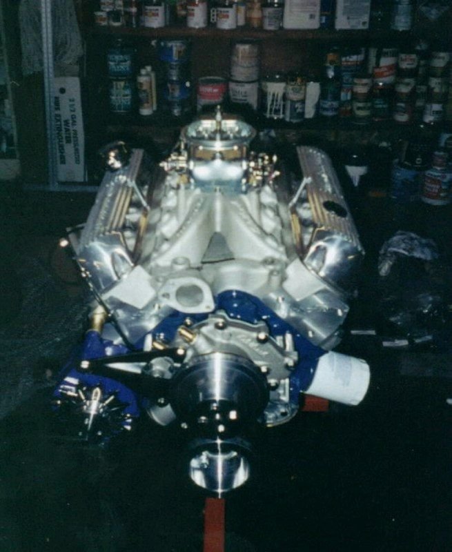

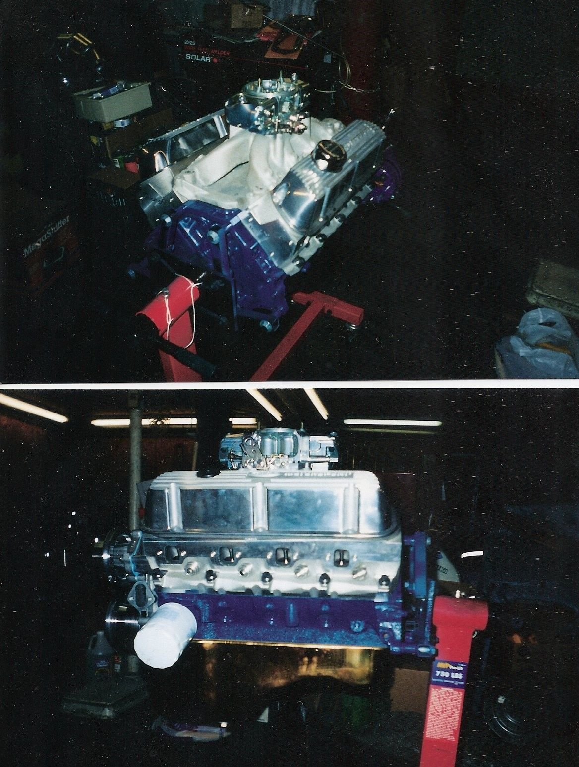

332" SBF - 4.030 bored '72 iron 302 block. 3.25" stroke old Eagle (USA made) steel crankshaft, old Eagle(USA made) 5.5" H-beam rods, free floating pins w/ JE forged ultralight pistons, 11:1 CR, cam is a 250/260@.050 w/106 LSA solid flat tappets, ported Track Heat heads, ported Victor JR intake, 750 Race Demon carb. Edelbrock mechanical fuel pump, aluminum underdrive pulleys, and a manual steering rack so there's no p/s pump. 530hp at the crankshaft, I shift it between 8000-8500 rpm depending on traction. The car weighs 2450 lbs on the scale, with 3.10 gears in back, in a 9" housing taken from a 1959 T-bird. Wheels are 1995 Cobra R 17s, with 255/40ZR17 Toyo Proxy R888 tires. The automatic transmission is a manual shifted reverse valve body C4 Roller Mite w/5000 rpm converter from Dynamic Racing, and I shift it with a B&M megashifter. I've never raced it on the strip, but it's pretty quick from the GPS test runs. It's a handful to drive when I'm into the throttle, I shift into 2nd gear at 80mph, and into 3rd at 136mph. I'm not sure what its exact top speed is either, but it's gone fast before. I guess a theoretical top speed would be 204mph @8500 rpm, but there's no salt flats here in upstate New York to test it. lol
This is an ever-evolving project, I've spent much of my life playing with various drivetrain setups, etc. It's a labor of love.
My 500+ HP Mustang II and my Cummins-powered '78 Bronco in the background.
