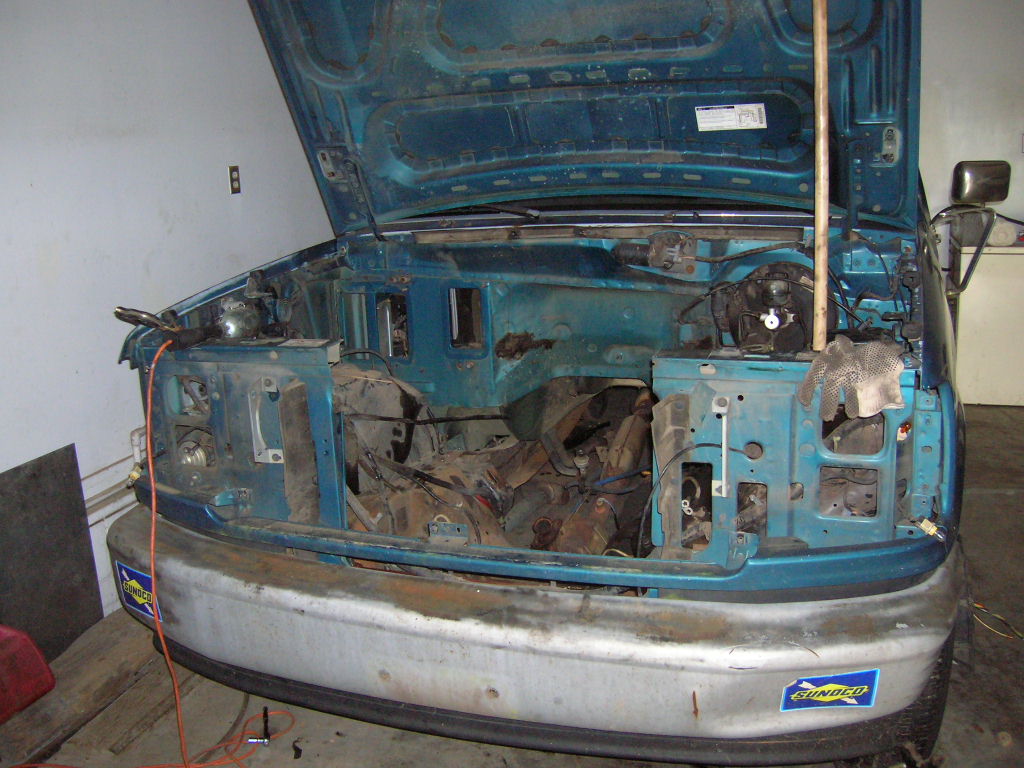

got the old motor out today .. not gunna be as easy to swing that 650 LBs 429 over the rad support so i cut some of it out . it can welded or be made to bolt back in easy enuff ..not sure how many times in and out the motor will need ..i have frame and motor mounts from an older model if needed .. not sure if i need a rear sump oil pan yet .. the 302 was rear sump but there is lots of room and if need be i can raise the engine an inch or so ..gotta find a coulmn shift automatic column .. want to find a non power steering unit and non power brakes system .. want to find a non air heating system ..i`m one who the only power stuff i want is what the engine makes ..i dont think fuel and ignition systems will be much of a prob ..just revert back to old stuff ... got a busted 5.0 if anybody wants it ...

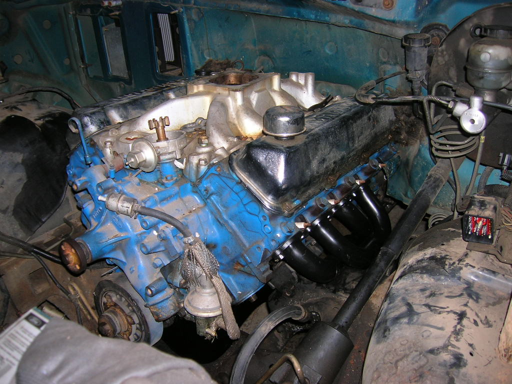

the motor is sitting in place .. it`s gunna be an easy fit but i`m gunna wait to screw it down untill i get some headers to fit .. stock manifolds are out of the question .. i know i had headers on my 70 ford truck with this same motor in it but i dont remember the application to look up a part number ..there are headers for F250 and bigger stuff .. that`s where i may go ..shorty hotrod hearders are outrageous .. starting at 500 bucks .

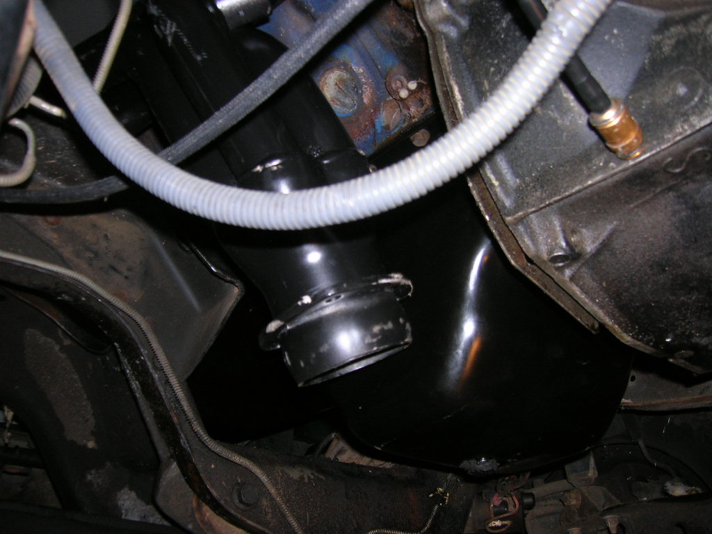

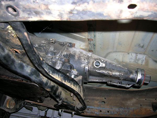

as i said motor is sitting in place .. headers came in yesterday ..fit perfectly ..had to change to the rear sump oil pan .. no biggy ..this motor has had that before when it was in my Tbird ..with just a minimal amount of firewall denting the motor is sitting on the stock 302 frame mounts with the stock 429 mustang motor mounts .. simply have to drill a new hole for a cross bolt .. the trans crossmember and mount fit right up .. got to drill one new hole to bolt it to the frame ..only bummer at the moment is i wont have a speedo .. unless one of you knows how to adapt the electronic speedo to the old type tranny ..have`nt tried the driveshaft yet ..but as easy as everything else has been i expect it to fit with a simple yoke change ..
