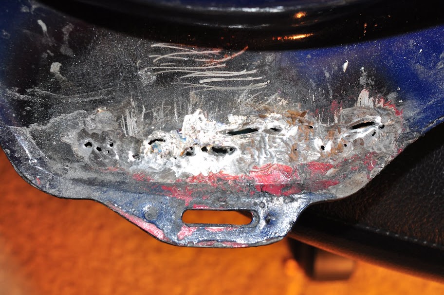

I think a picture is worth a thousand words here:
"several pinhole leaks popped up"
Never seen pins that big!
Looks like you need to weld a section in. Are there bike junkyards?
Old Mar 11, 2010 | 03:52 PM
Cavero's Avatar
Joined: February 13, 2006
Posts: 2,523
Likes: 150
Well now, I never said what kind of pins they were! They started out as pinholes but the acid treatment opened them up

Ooh, wow. Man... that's gonna be tough. I saw your reply in the other thread, so I understand... Is that the underside? is the top side ok? If so...
Contextually, that picture needs help... but it looks like we're talking the underside of the tank, so....
You should cut out a 'cat's eye' shape of that bad metal and toss it. Then get a piece of flat metal, and weld it in there.
A shop could do that in about 20 minutes. 30 tops. It doesn't even really have to be very pretty, unless you plan taking the tank off and showing it off under there... Just cut enough to get rid of the bad rust holes and weld in a new plate. I'd say that if you had the metal cut out, and then just have a piece that'll weld up right over the hole, not IN it, just over it... and weld the edges good... you wouldn't have to do anything else except, IMO, epoxy seal the thing like above.
You may even be able to just weld a cover plate over the holes, provided the rust is gone, and just epoxy seal it too.
But I don't think you're going to save that holey metal. It's just too... bad.
I don't think it even has to be terribly pretty, overall, just functional. It's on the underside... does it show much?
