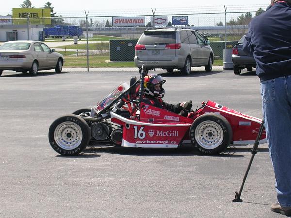

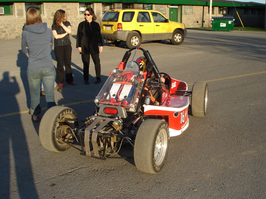

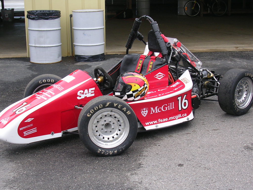

Howdie everybody. I posted a while back about the electric and hybrid snowmobiles i helped build at school. Well we've applied our skills to something with wheels now. This was the first year of the SAE Formula Hybrid competition, and we took first place with this fella:
http://www.youtube.com/watch?v=JvCZwB5wnHk
Its got 10 lithium cells under each of the side pods, plus a little 7hp single cylinder four-stroke connected to a DC generator to recharge it on the go, series hybrid just like a Chevy Volt or the HySeries drive from Ford. The electrical power is delivered to an independent rear-wheel drive set up. Each rear wheel gets its on motor and CVT.
The motors are only about 15hp each, but they put out a lot of torque. Unfortunately, during the competition and for that footage, we hadn't really had a chance to instrument the car, so we've had to cap it with some pretty cautious current limits so as to not fry anything, but give us some time and we'll have this thing flying. We'll be doing testing on it all summer long.
