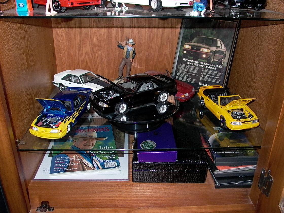

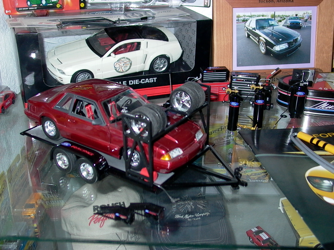

Here is a shot of my Foxes...
Attached Thumbnails GMP Wheel change Help!-p1020002.jpg   GMP Wheel change Help!-p1020012.jpg   GMP Wheel change Help!-p1020003.jpg

Am building one that looks like mine.
Old Aug 3, 2008 | 01:02 AM
jacostang's Avatar
Joined: January 27, 2006
Posts: 3,613
From: Mesa, AZ
Super Cool!
